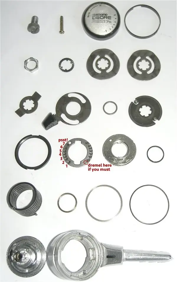

Really dont know what this talk about drilling an extra hole is about? Have you not disassembled one? There is an extra hole, it was just not intended for an extra gear, it´s for the spring in the lever to hook into. That´s where the "extra click" is coming from. Yes it´s not 100% spaced correctly and because the end of the spring is poking through not 100% as deep as the other dimples, and it´s just on one side of the clicky ring, but if it´s good enough for Kona to spec thumbies with an XTR rear hub as OEM, then it´s good enough for me.
For a more affirmative click you can dremel an extra dimple on the other side, but it´s not strictly necessary IMHO (I never bothered) as the click is on the end of the travel of the lever anyway.
For completeness: Same goes for 6sp thumbies with 7sp cassettes. The play in the upper pulley of Shimano RDs will take care of the slight difference in spacing.

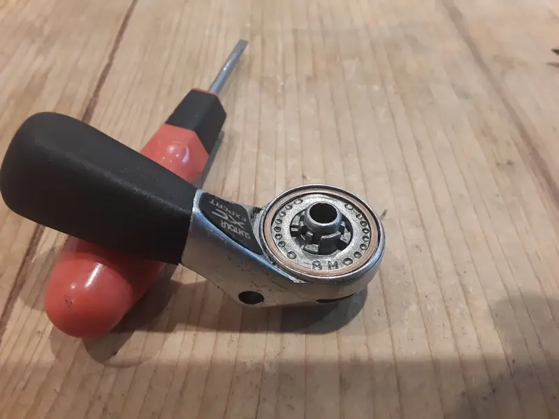

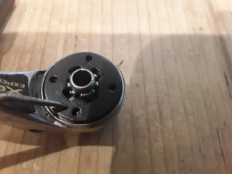

Yes.. there is a hole....but its not for that....its a hole not a indent, so the bearing goes right in, its also not spaced correctly ( see the others spacing) and its larger.
My assumption is it there to deter you from over-driving the shifter any further round....to stop you damaging it.
But yes, it will serve as an 8th, all be it inaccurate gear......but then you can also use a screwdriver as a chisel.
Just for reference here is the inside a a switchable suntour thumbie i rebuilt......8 indents.....8 speed.
The last hole is blanked off when the selector is switched from 8 to 7 speeds.

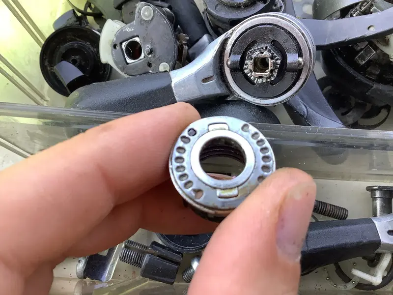

Yes that‘s exactly where I’m thinking. Yes that click is very important (it somehow makes me happy). Now, the hole, that also acts as the holder for the return spring. Since the spring is tensioned the other way, lengthening that hole so that the bearing reaches further creating an even spacing. Then dremel dimple other side. Think I got spare parts of these anyway, so could F it up and not worry.
EDIT. Looks like there’s gonna be an issue. The spring reaches to the top. Maybe filing down the spring too.
