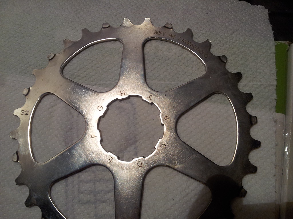

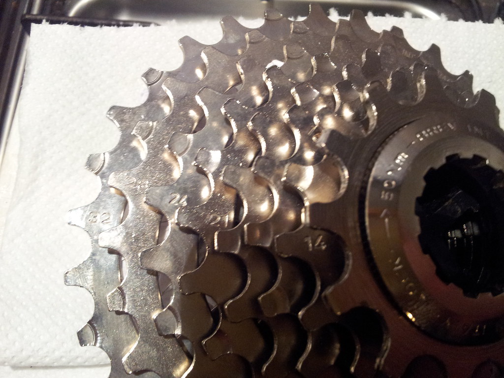

Last week I picked up this unused cassette off Ebay for just under £27 posted.
The two largest rings are 28T and 32T.
Due to the diversity of Campag separate ring cassettes, I can keep the 32T as a spare chainring, make the largest cassette ring 28T and fill in the gap with an easily found cheap smaller road cassette ring.
28T is a plenty low enough cassette with these compact chainsets.
Spare chainring:
