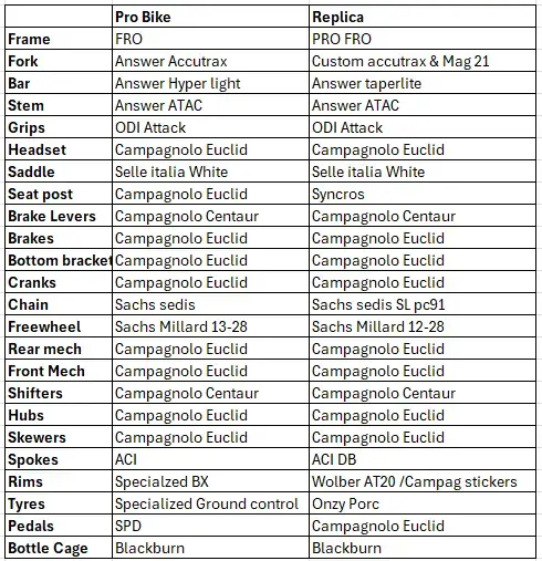

I was tryign to build a Yeti team campagnolo homage build. Its taken me more that 10 years to get close to the parts i needed. Anyways I have had trouble getting the gears to index. Please note i have been a shop bike mechanic, race mechanic and builder for 30+ years and have built 100s if nto 1000s of bikes. But i dont about campag Euclid and Centaur gears.
I tried to get as close to the same set up as the pro bike Centaur shifters, and Euclid rear mech. Sachs rear Free hub.
First time out i used a SRAM 8spd chain (as they bough the Sachs tools back in the day) and a regular Sachs freewheel. The gears would change well on 7 & 6 then get works then over shoot on 3,2,1. Or change for 1,2,3 and then you would have to over shift on 7,6. I thought maybe cable on the other side fo the bold ont he rear mech, nope thats worse.
Maybe the chain and the freewheel, so at great expense i got a Sach sedis PC91 (SL) chain correct era and the Sachs Millard (syncro) freewheel. Still the same issue either 1,2,3 work and you have to over shift with the thum on 7,6 and it can drop back or it shifts 7,6,5 and jumps on 3,2,1. do i just make it friction?
Is there a known set up for this that i cant find? i am being dim and have missed something? Is there a sprecific campag freewheel i need? I think i need the collective clout fo the retrobike brains to help. all ideas welcome.

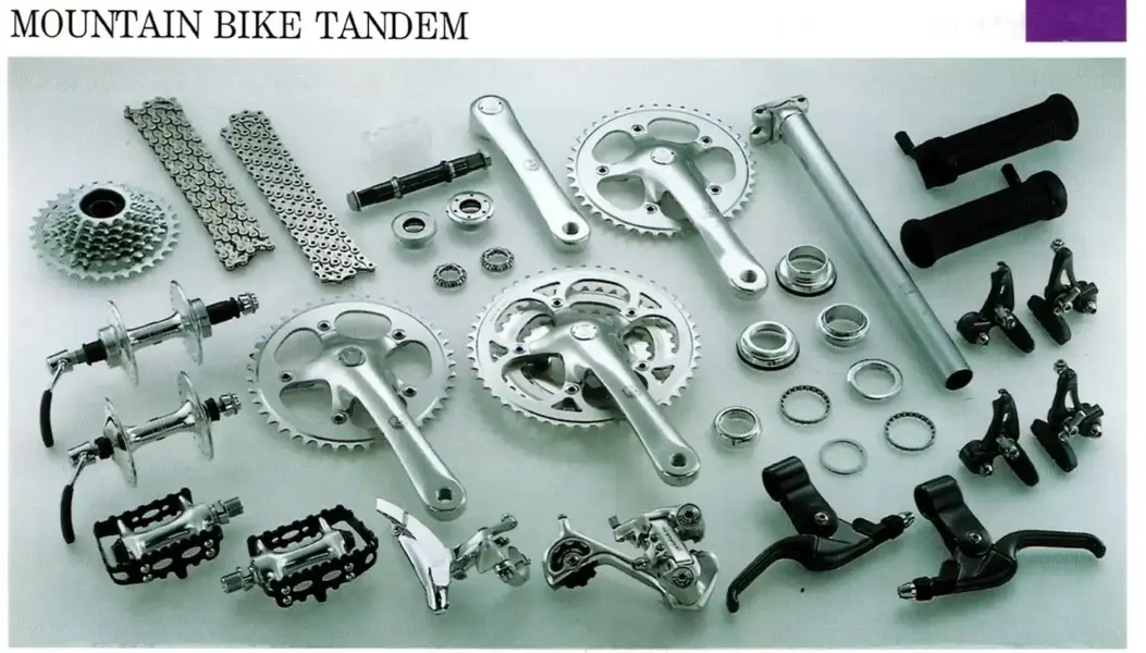

This is an interesting thread so I did a bit of digging in the RB archives. The '89 catalogues for both Centaur and Euclid show screw-on rear hubs as part of the groupset, but the only thing missing is a freewheel. There's no mention of what Campag suggest to use surprisingly given they do mention their chain is a Regina one. As has been pointed out above, they move onto cassette hubs from 1990 on. However, for the mountain bike tandem groupset you can see (pic below) that they did produce a 7 speed freewheel, so I guess they're out there somewhere.
