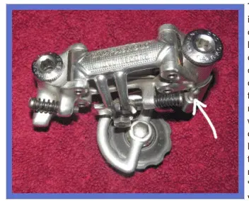

Can anyone tell me what the small screw on the bottom of a vintage derailleur? I can recognise the upper and lower limit screws but baffled by the extra screw.

....it's the pivot housing stop screw that keeps the jockey wheel cage tensioned correctly
Griff
If you remove the screw and allow the cage to rotate so the tension is fully off the spring, then when you unscrew the bolt everything doesn't jump out of your hands.
