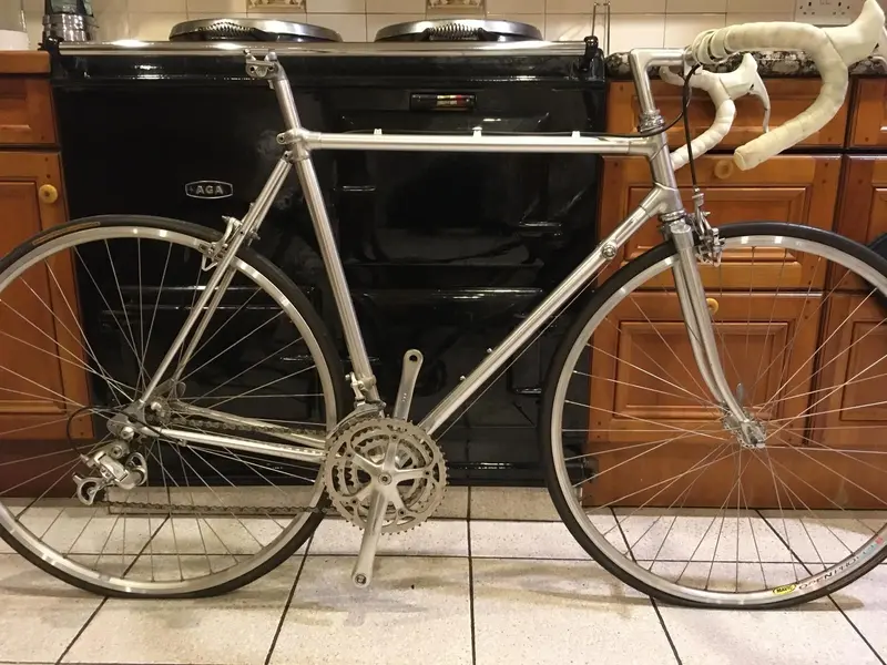

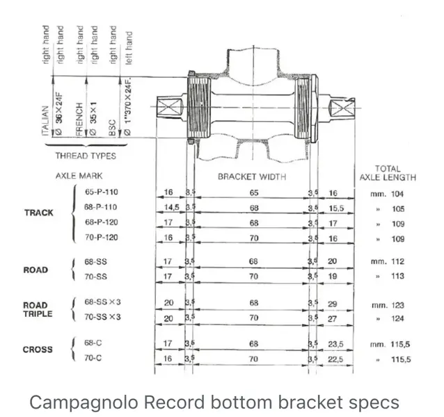

Looking for advice from the wise people of Retrobike. I have been asked to restore this beautiful Alan road bike. It will sport a super record drive train replacing the dogs breakfast of 90s campag triple components. I know that I will have to swap the bb axle but am unsure how to work out the correct length. I am ok just to get a 111 mm or is there more to it. I will re use the cups and bearings as they should be ok. If anyone wants a campag triple crankset derailer and bb axle please message me.
