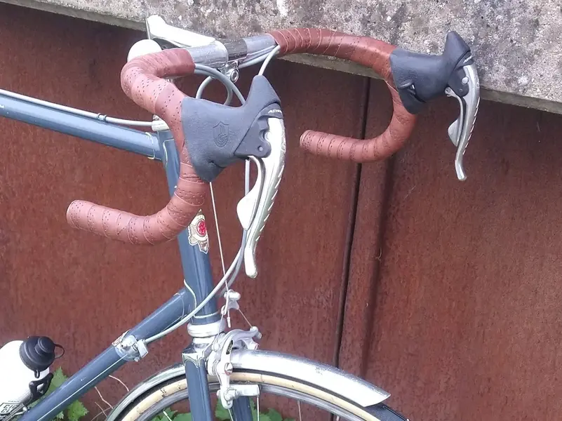

Have just installed a couple of Athena 8-speed levers, BTW. Because I love how the classic looks of those early Ergo levers work both functionally and visually with a vintage bike:
