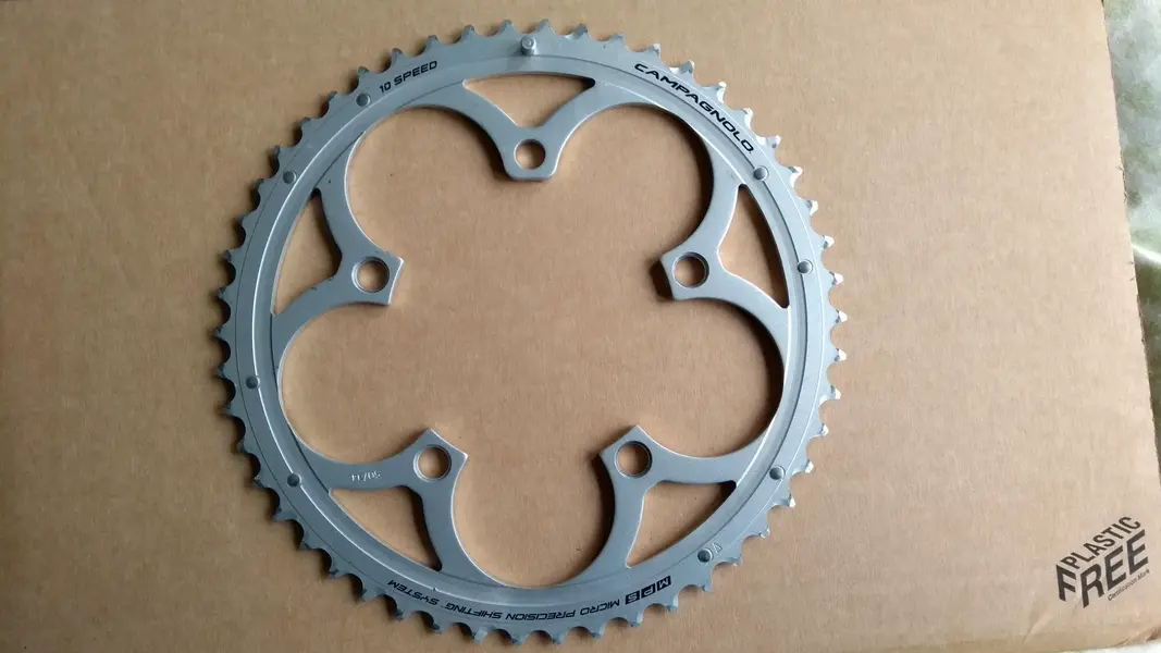

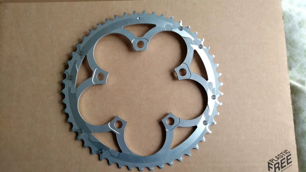

I have a 50t one available. Probably Veloce or similar not Chorus. It has the offset fifth bolt hole which I think was common to all 10 speed Campag compact chainsets.
Hardly used - £25 posted to UK mainland?
