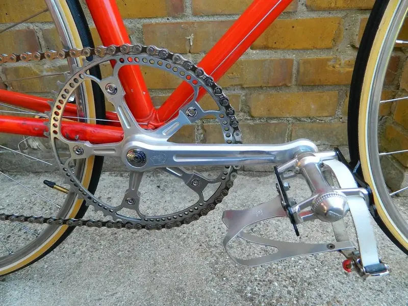

here is a pic of my double SR chainset turned into a single for my TT Bike :) Simply filed off the inner support :)
I ran this with a double 112mm Axle as the trend then was to not have any flattening of the chainstay and the short rear end meant the angle of the chainstay was quite acute. Quite a lot of people had to run a double axle on a "track" chainring on a TT bike..........
Shaun
"Quite a lot of people had to run a double axle on a "track" chainring on a TT bike.........."
Exactly the problem I had on my Emperor Sport Shaun...
Campagnolo Pista BB resulted in grinding of chainring on the chainstay so had to go with a Campagnolo Double BB. By the look of the chainstay it may have been an issue to previous owners as well!
Steve.
