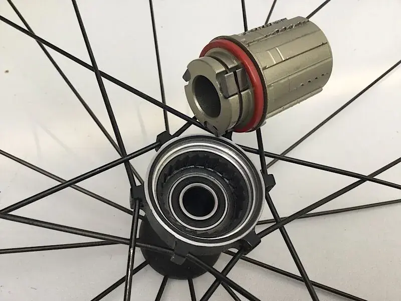

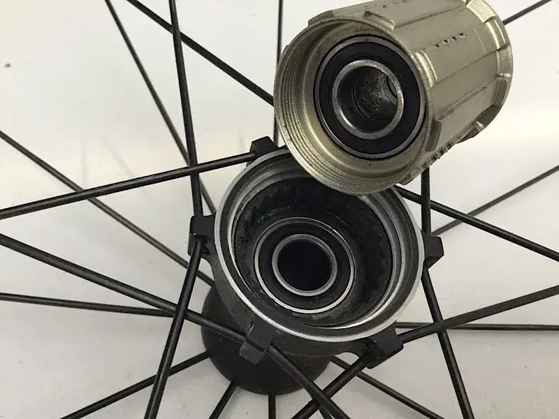

Hi all , I’d like to change my Shimano freehub body to a Campagnolo 10 Speed . It has a 12mm axle
Can anyone point me in the right direction for right one please.

Ok thanks, I had seen this type but was unsure regarding the seal on the end .
Maybe a case of buy and try and return if not .

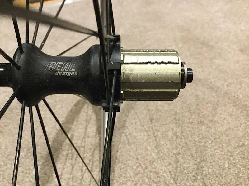

Real design hub , I believe these are made by American classics ..

Could be a Novatec hub there are a few importers for those and easy to get hold of.
The Cycle Clinic can’t remember who he is but used to post on here I think.
Type A freehubs come in three forms and all run on a 12mm axle, have two 6901 bearing/3pawls;
Type A 8/9/10 speed Shimano/SRAM
Type A 8/910/11 speed shimano/SRAM ABG freehub (anti bite guard a steel strip on one of the splines to stop serious notching)
Type A 9/10/11 speed campagnolo freehubs
