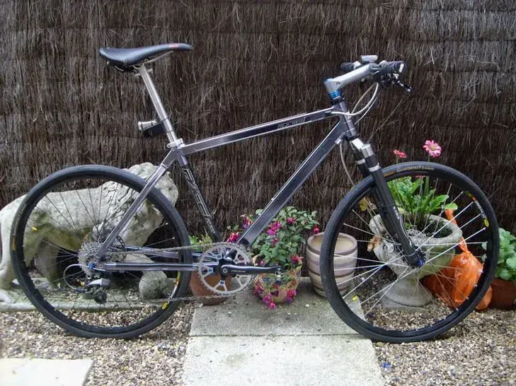

Here's mine with original decals which are a bit tatty now, but in the correct position.
I did the same as the chap above regarding the internal cable, I find time, patience, and shouting at it helps.
Well done on getting an RC300 they're lovely to ride and really light. Just about to post mine on lightbikes.com when I get a better pic in xc mode (17.2 lbs 8) ).
Regards T
