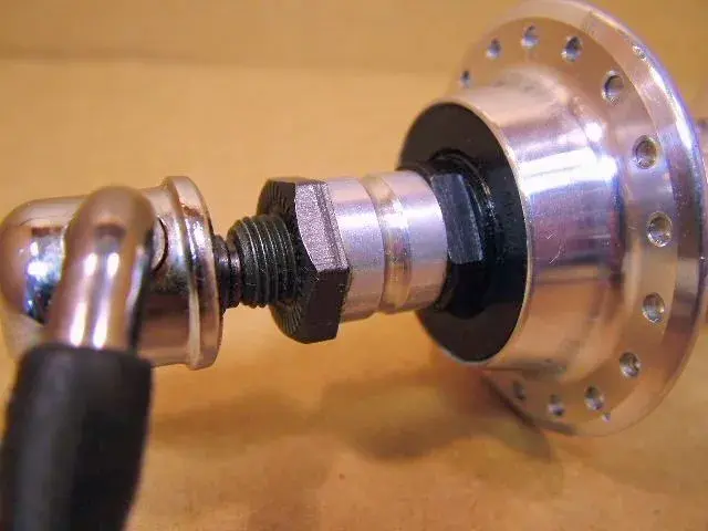

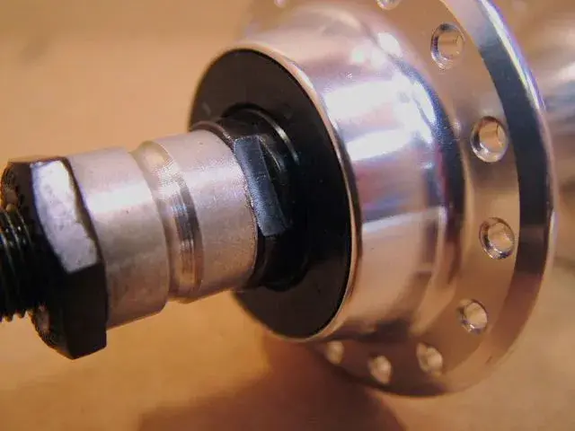

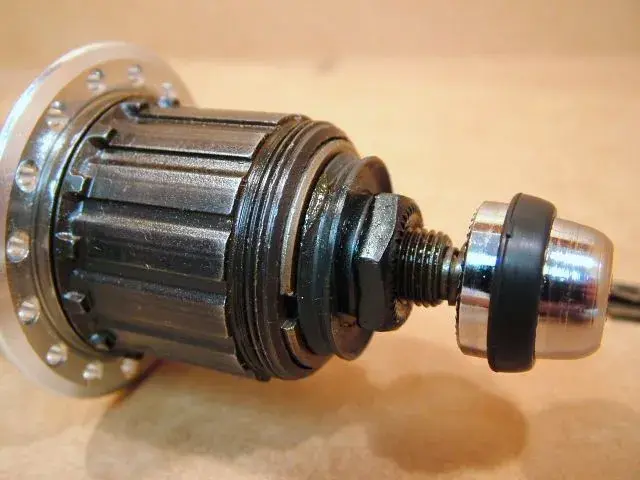

ok quick search and a nice chap on ebay just happens to have the pictures I need.
Top two are the 7 speed MD
Bottom 2 are the 8speed MD
notice how the 8speed sits in the hub shell a bit more (altered by the metal spacer behind it).
If yours looks like that then all is fine.
I'm adding here for reference and because I wasting time waiting for my tea.

Funnily enough, that's how my setup looks if I recall correctly, but when I mount the cassette it ends up looking like this. If I wasn't such a mechanical numpty it would be a lot easier!

Alu spacer on NDS is I would estimate the usual 2.5mm shorter and there is a spacer between the rubber seal/shield flats and the locknut that is not on the 7sp, guessing it's the 2.5mm
I cannot measure as my measureres are all missing (vernier and metal rule) but 2.5/5 are usual for 130/135 alterations.
Brilliant. So in essence I need to take 2.5mm of the NDS spacer and put that on the DS. Makes perfect sense to me.
