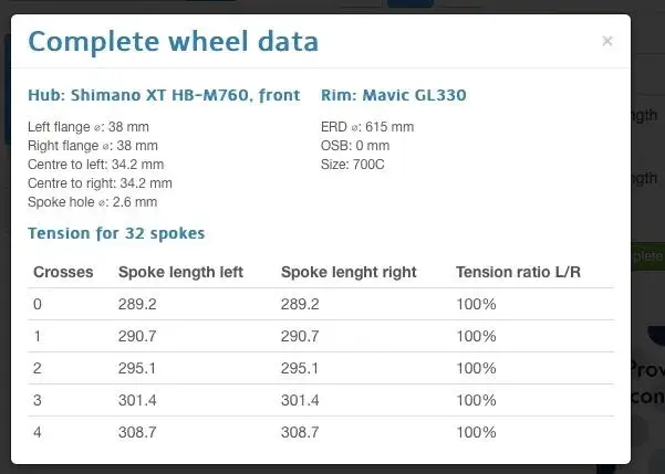

Assuming that GL330 is 700c then the spoke should be 301 or 302 mm in length for the front as is.

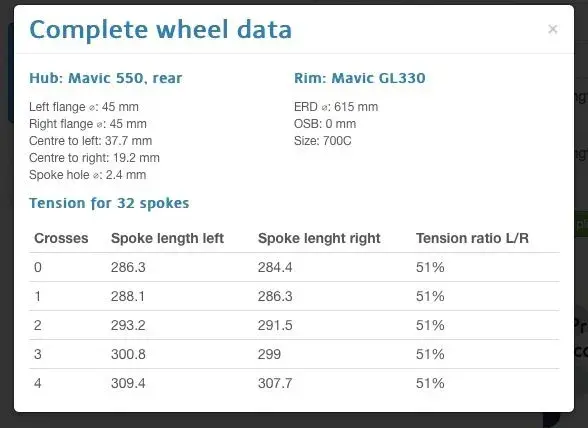

For the reward setup it would be 299/301 needed.
So see what length they are. If 301 then you may get away with it, if 300 your probably good to go, if 302 then you may be past or at the end of the nipple head and at the end of the spoke thread.
Assumed 3x 32hole but do your own calcs. Data is here http://leonard.io/edd/

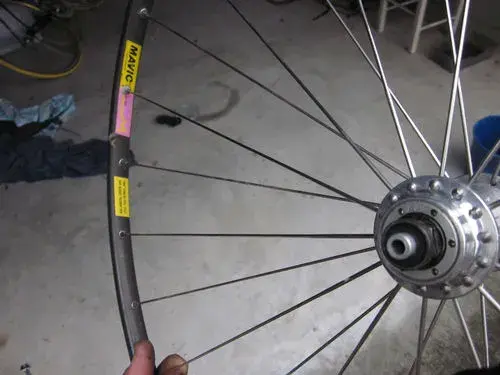

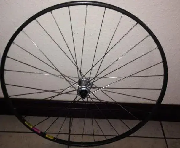

thanks for looking at it, I will lace them up and see what happens , the rims are road tubulars which will give me a little more jiggle room at least
Might be near enough spot on
Spokes are never cut particularly accurately any how...maybe when you strip the new wheel, sort the spokes and keep longest for the LHS . Or even just trim them a fraction on a bench grinder

yes they are 32s , I already have a radial laced 28 for the front

I reckon you may be right Skyfarmer , but I think I will lace it all up first just to check if i can avoid a grind
At least you will be able to go back if you don't grind first I guess.
I have found in the past on commercially built and cut spokes, up to 1 - 1.5 mm or more difference in spoke lengths any way..so at least grade them as you take them out the original wheel.
