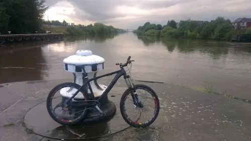

The final version was this but with a saint crank and some Hope Moto v2s, sadly I can't find that photo.
Very usable 1x9 do it all bike.

So,
I went off too see Bob, a nice drive upto Harrogate and patience from him with my travelling through rush hour too come and collect got me a lovely raw colour medium 456c complete with superstar headset and ks lev seatpost (non optional, it's stuck 😅 conveniently it's stuck at my riding height)
