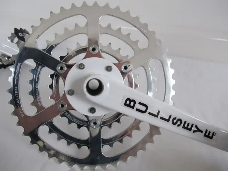

I've also refurbished the crank and to be a little different I’ve ditched the spider gone for TA Cyclotourist chainrings (as Bullseye originally intended) to give it that 1980’s feel. I’m sure this isn’t going to be to everyone’s taste…

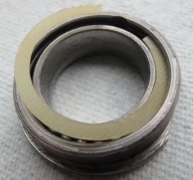

I got some 0.5mm glass fibre impregnated board/laminate from a friend last month and cut out a new seal (killing two blades during the process), then "thinned" it down to approx the same thickness as the original seal but it snapped when I tried to fit it. :cry:

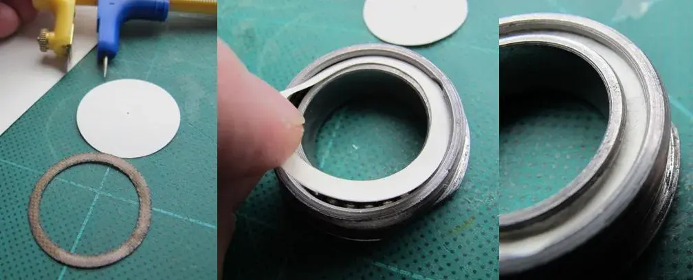

I then had to shelve the project but I had a brain wave a couple of weeks ago.....
Q. What's flexible, impervious to water & oil and is strong?
A. Tyvek®
I had some heavy gauge sheets at work and it seems to work well. Just need to put some miles on the bike to see how it performs.
Those chain rings look perfect...., i like 8)

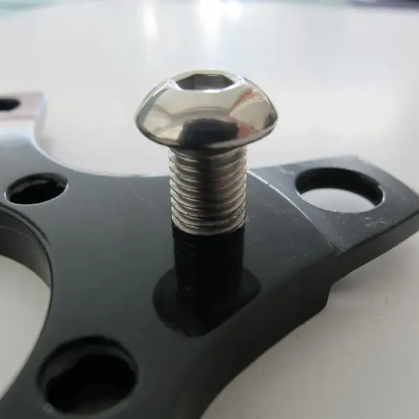

The inner chainring bolts are 5/16 UNF.
The spider is the same as the last photo but it's been polished and anodized 8) .

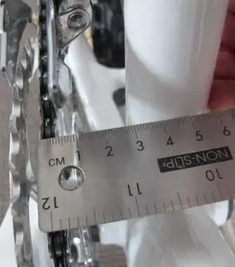

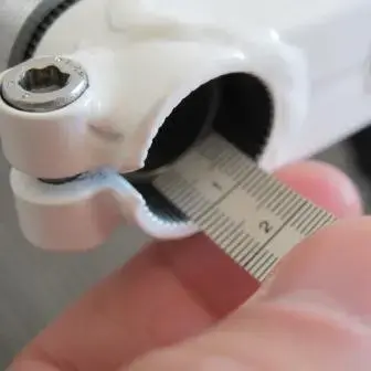

Next problem.... with the chainline at around 47mm the clearance between the chainstay and crank arm is a few millimetres (at best!). If I move the arm out to give around the same clearance as the otherside the spindle is 10mm too short. I’ve checked the total spindle length and that’s around 150mm.
So……… do I need a “special” 160mm spindle or do I compromise on the chainline? I’ve tried this and with roughly equal clearance on the chainstay’s the chainline is 40mm. Too short? Anyone got any ideas?
