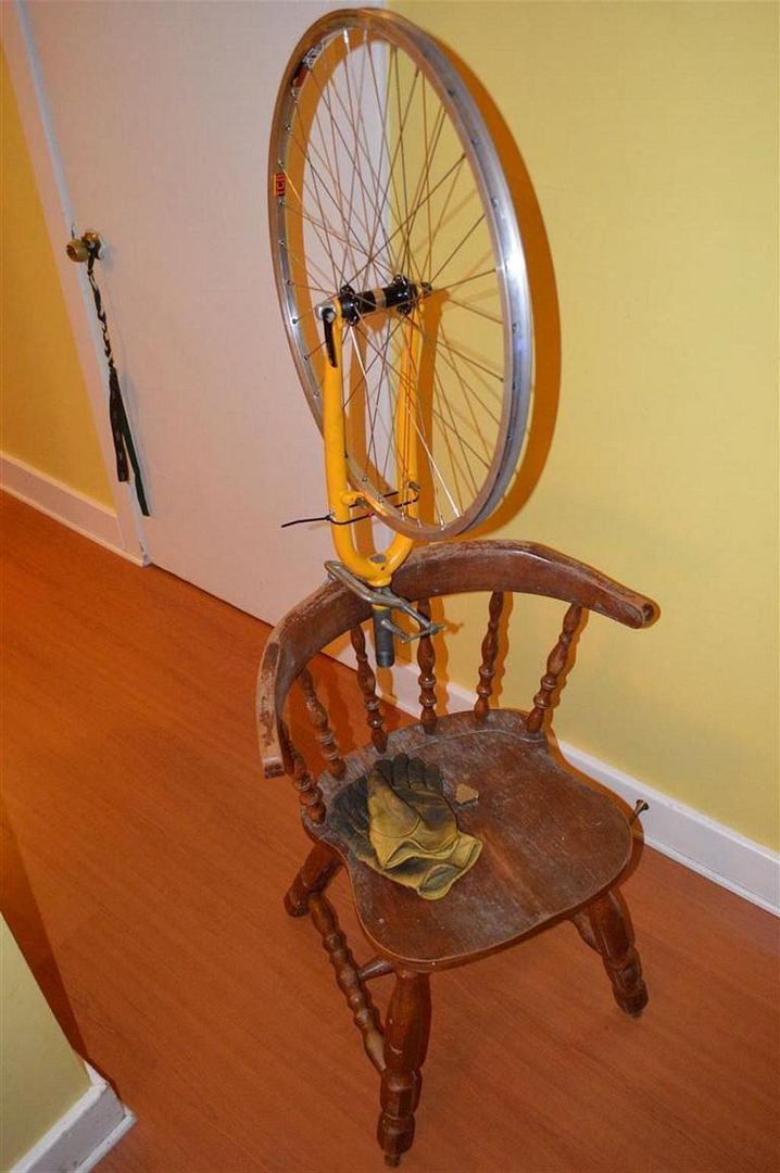

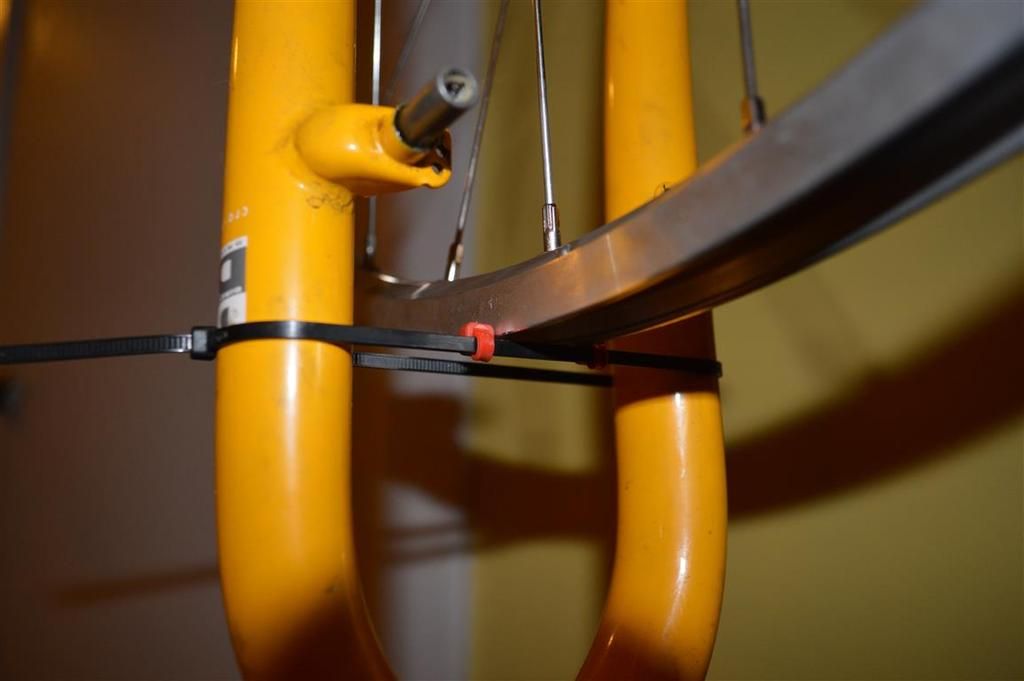

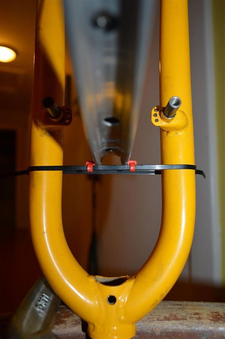

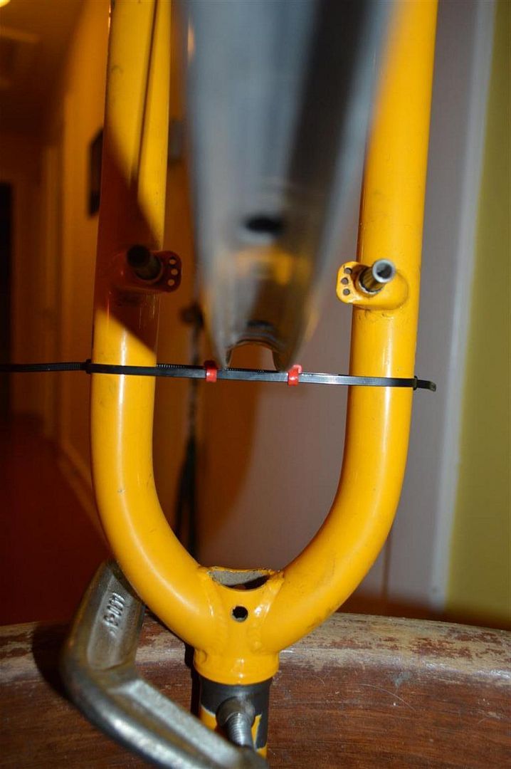

Now I mounted the wheel on my bike, which would serve as my wheel jig. I adjusted the V-brake pads for normal rim clearance, and put a heavy zip-tie around the chainstays just at the edge of the rim. On that zip tie, I put two smaller ones that could act as sliding pointers, for finer measuring as I go. The zip tie arrangement can be used to keep control of both radial and lateral trueness, with a little care and imagination. I made minor adjustments to get the dish correct (a half-turn extra on the drive side was all it took), and took care to get the rim radially and laterally true at this stage. I was satisfied when the rim was radially true within about 1/2mm and better than that in lateral.
