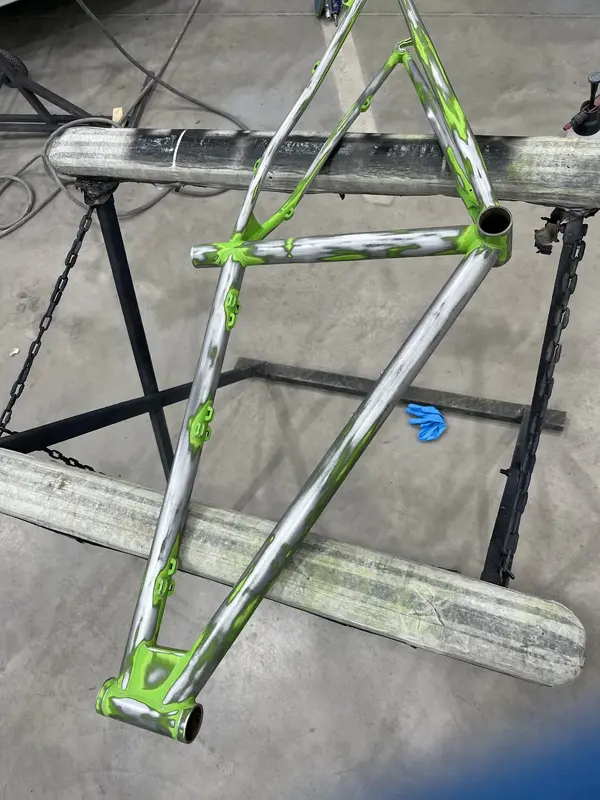

He asked for a new bike for his 13th birthday so rather than spend 300 to 400 on a Carrera from Halfords that wouldn’t be that good. I have decided to build him his first proper mtb sourcing quality second hand parts and new parts where necessary.
I work as a car spray painter so I am also going to do a custom paint job on the frame.

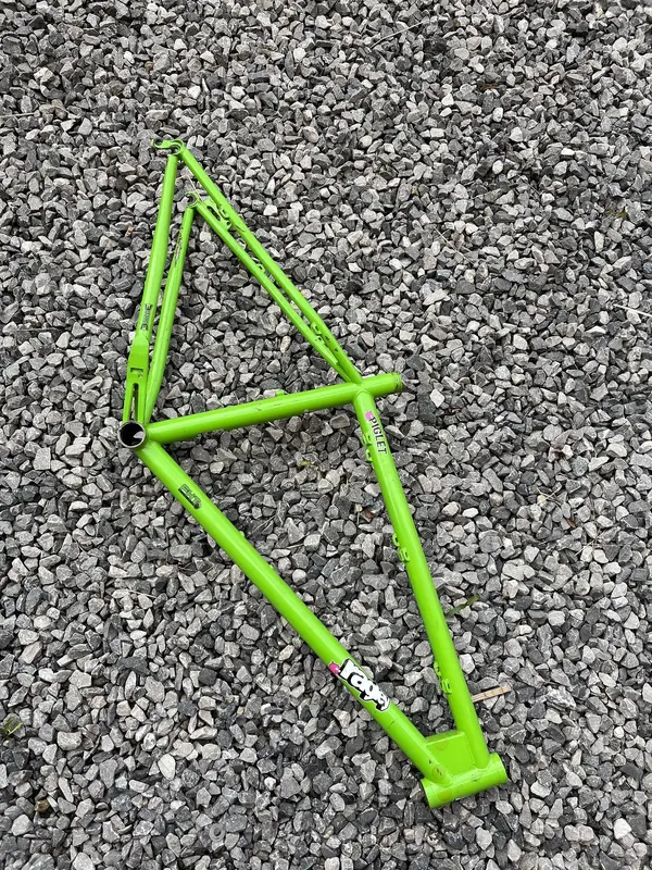

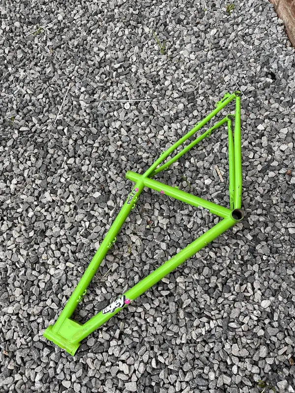

To kick it off I purchased a Ragley Piglet Frame from Scant on this site. Thanks to him as it’s in good nick and at a good price!
54E56FBA-4227-4ED2-B76C-0DB6984EFD79.webp 1AC6A45E-9369-4D78-B81D-D7F332753B54.webp

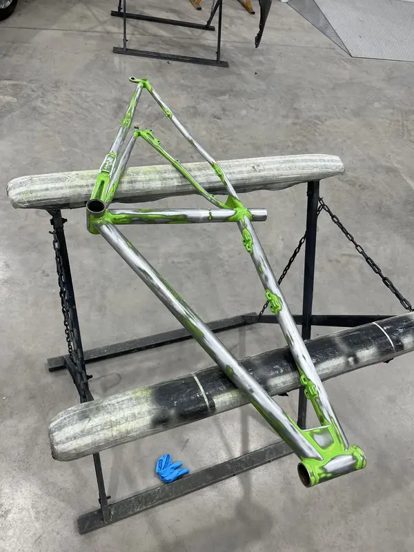

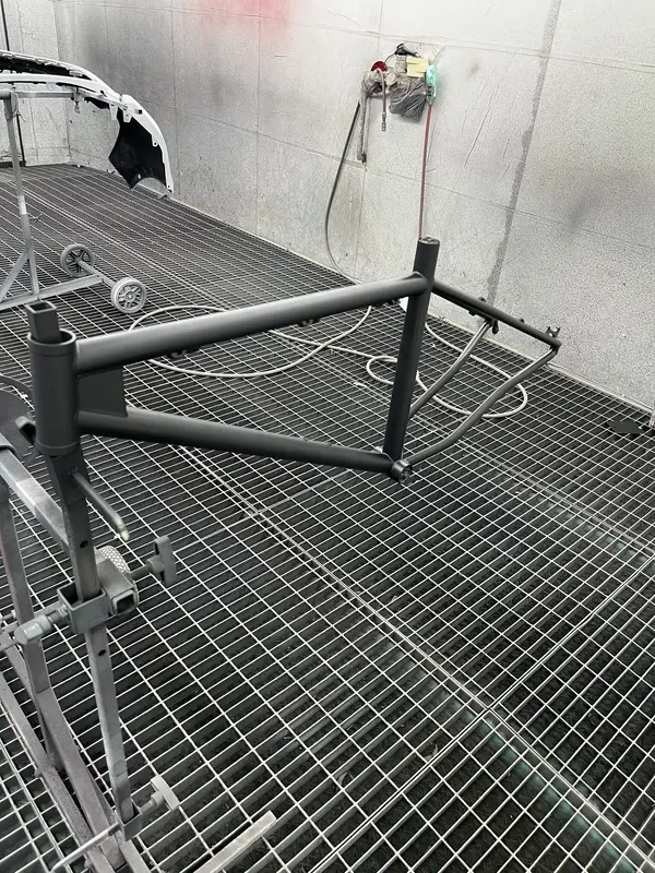

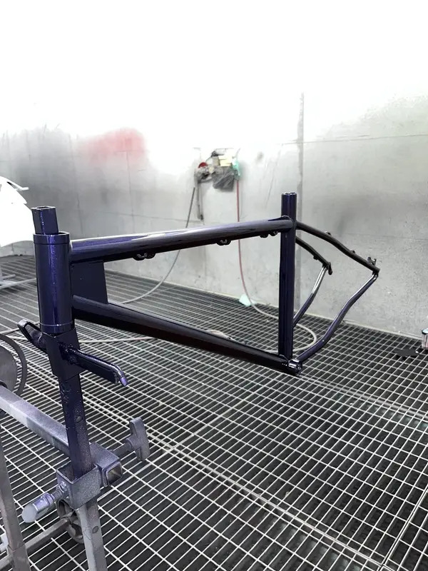

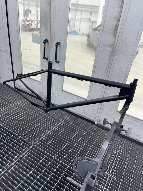

I took the frame to work where I sanded it back and prepared it for its new custom paint job. 4FE6A3E0-1C3B-42BD-9A17-718D34DE0E3A.webp 850E60D8-E887-4045-A0F5-0F36854903AA.webp

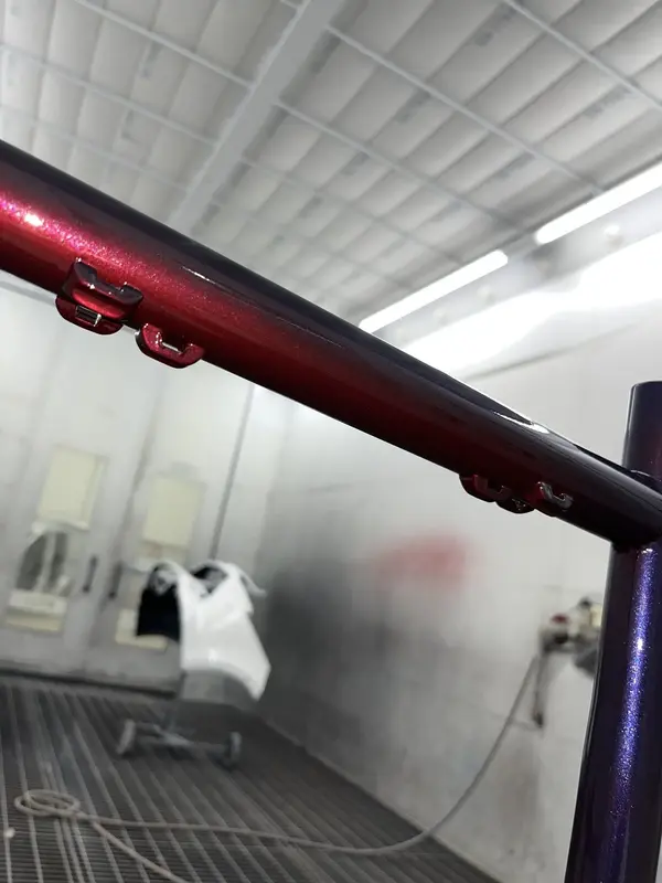

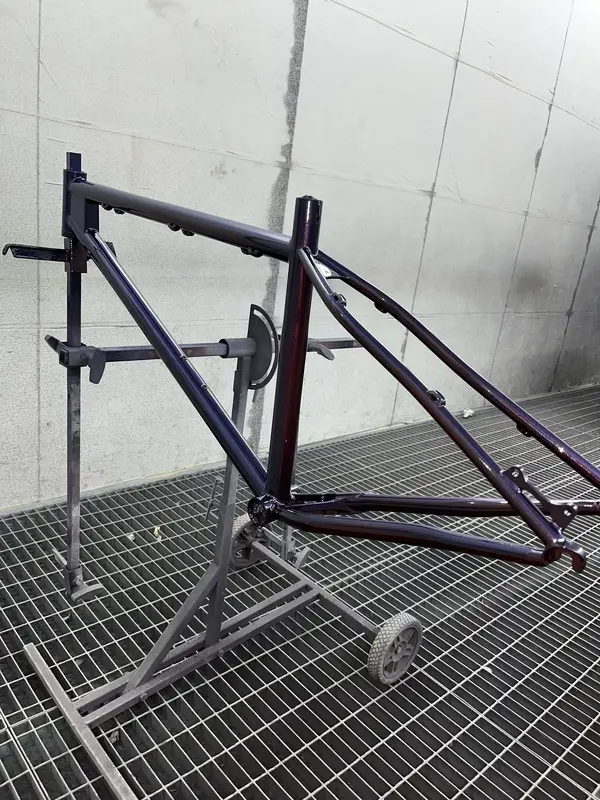

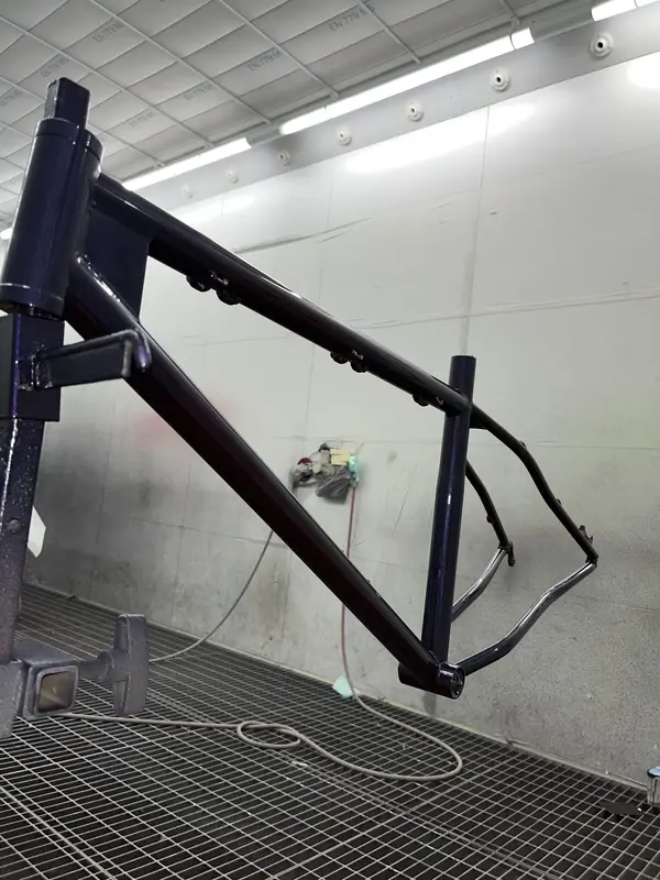

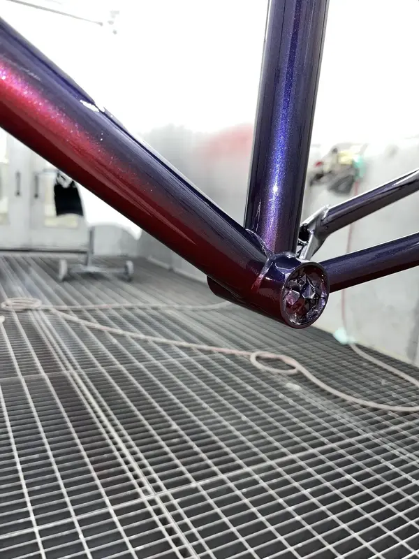

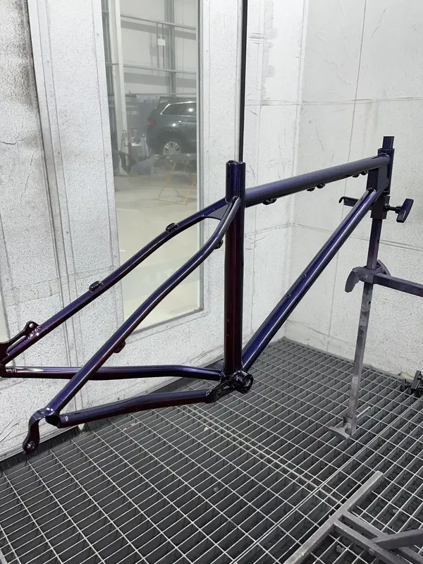

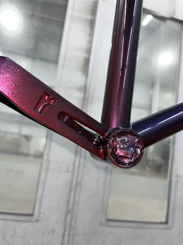

So when I had previously mentioned to my son if he could choose the colour for a bike what would he choose he said like a galaxy colour. In which he means like the galaxy Fortnite character skins.
So after some looking around online and at some colours I decided on a fade on the tubes from a metallic Pearl blue on the main parts and tops of the tubes with a burgundy red Pearl along the bottoms of the tubes.
So I had two spray guns set up with a colour in each and tried to see what I could do.
Here are some pictures of it in the booth after the clear coat went on. It’s hard to capture the colours on camera but the close ups with the flash on show it quite well.
Just need to scotch it all down again apply the new decals and then clear coat agian.
Let me know what you think
Cheers Kyle 86B7E6F5-FFB3-4FF8-91BE-2012B795729B.jpeg 36BBC624-7CB3-4F24-9E92-BCF3714648B1.jpeg 5827AB5D-6238-45C4-ACE6-18DC512B3391.jpeg 68151759-7F81-41B3-A1F5-2E7FE5825B67.jpeg FF057935-E149-474B-974D-A11CAEB02135.jpeg A618F62A-379C-4DBE-A2E6-25FD16A9BBD5.jpeg 0134FC07-A76F-4E55-95F8-CB279D16BD35.jpeg 8CB8E90C-C1F4-4404-9421-EDAC17D435A9.jpeg D7B6D219-D92C-48A2-9755-840F7B0627D8.jpeg C89B88C1-859B-42D1-9021-EAFFD703EAC9.jpeg
