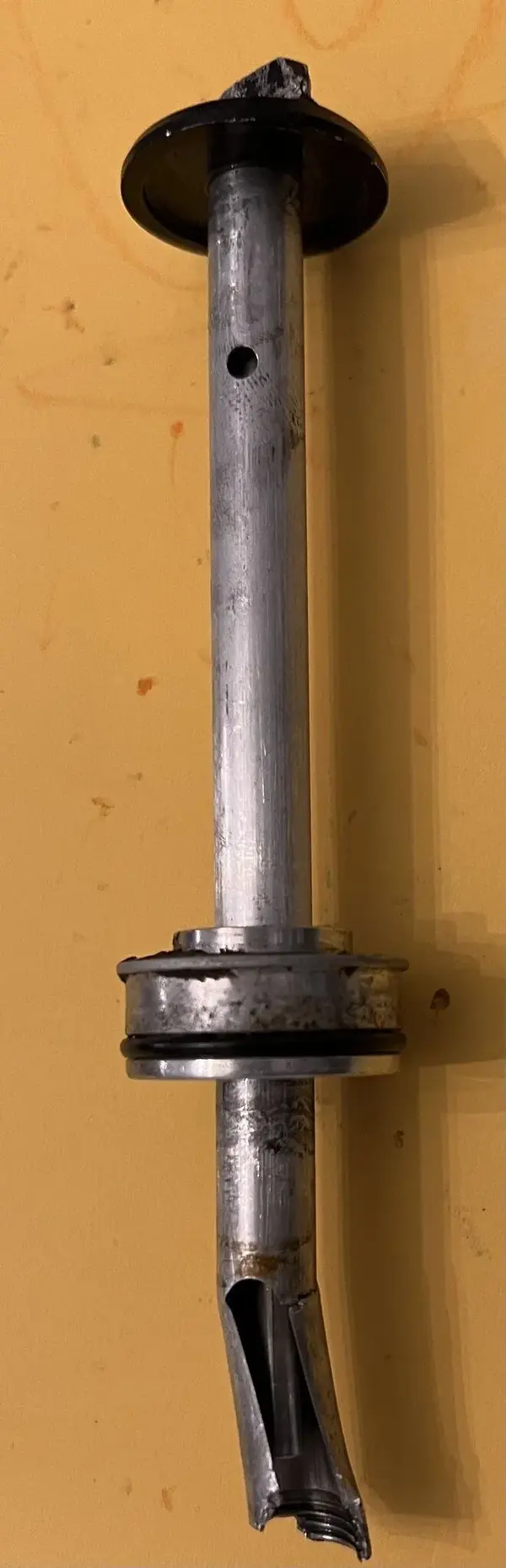

Just managed to acquire a set of 1999 pace rc36 evo2’s but the damper adjustment felt awful, once I had opened them up I found that someone had clearly used a huge amount of force and managed to snap part of the damper.
How does the remaining part of the damper come out of the Stanchion and more to the point does this look like a write-off?
I am trying to work out how to get the rest out of the stanchion but any advice would be greatly appreciated.

The part stuck in the fork is very difficult to remove, the damper body it is screwed to is bonded into the stanchion… but… I have a fantastic special tool built for me by Richard Hardisty just for this occurrence. If you send the fork to me I can remove the remains of the control valve and sort a replacement or rebuild yours with new parts.
