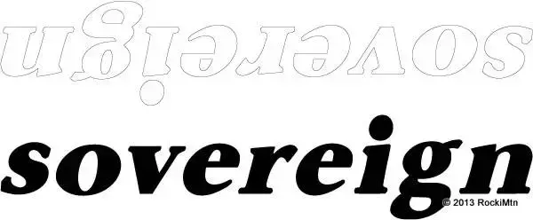

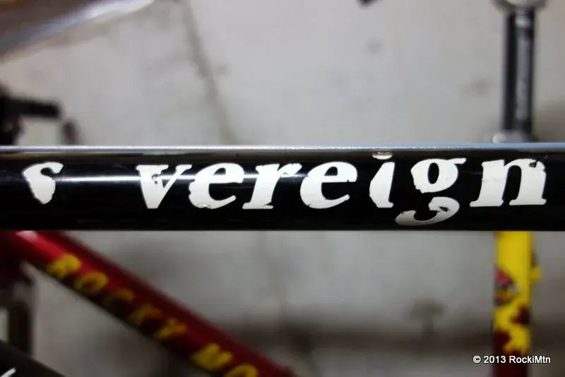

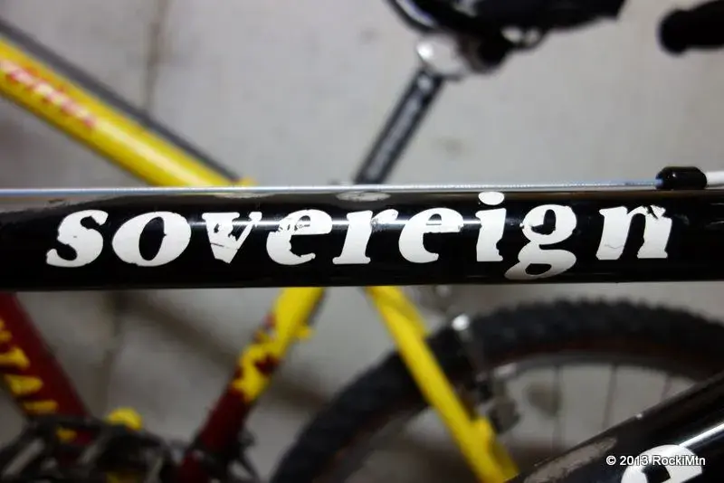

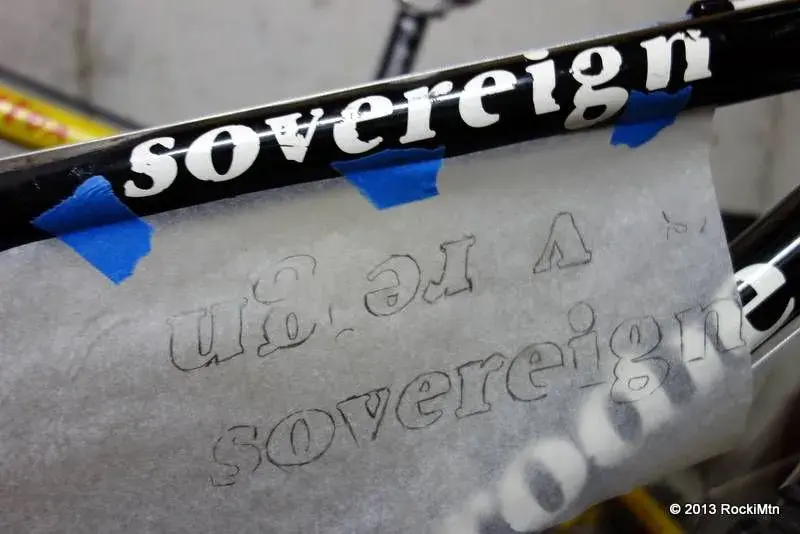

completed the digital hand trace from the scan of the physical trace. a lot of tweaking applied using a composite of the decals from both sides as neither were really complete for any of the individual letters. i think i came up with a good representation of what it should be.
Nice one 8) a neat trick and a nice build. I love the brodie geometry/style - to digitise the decals, did you trace them in illustrator or some other vector based program?
thx! i traced both the left and right side on one sheet so i can reference the placement in relationship to each other. i then scanned in the trace i did and cleaned it up in photoshop. overlayed the left and right side trace on top of each other to get the best tracing. them pulled that into illustrator and hand traced from the scan, then tweaked it comparing to the actual decals. then when i was happy with it, i cloned the single side and rotated and mapped it to the other side so that when printed i can hopefully wrap it around the tube in one go.

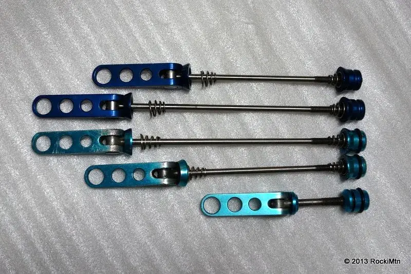

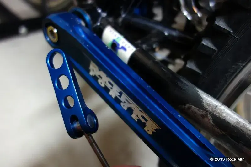

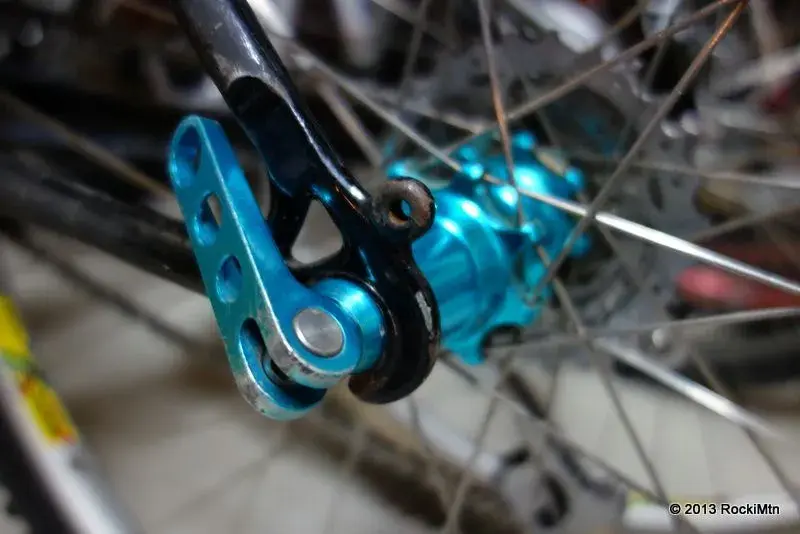

i've also picked up two sets of Ringle 3-holed ti QRs. one set is lighter turquoise and is a complete set of three, although i can't use the seat binder on the Brodie. the other set is a darker blue set, in MUCH better condition. my dilemma… i would much more prefer to use the nicer set, however the colour doesn't go with the pulstar hubs, but matches the rest of the blue parts on my bike. however the turquoise is a perfect fit for the hubs. :roll: :facepalm:
the hubs on the wheelset are the odd man out with respect to colour on the build, but i still want to use them, so i'm leaning towards the turquoise, less pristine condition QRs… THOUGHTS?

Like you said Frank, there are so many of the blue parts that do match one another that I would use the darker skewers and ditch the hubs! If you're hearts set on keeping the hubs then I guess you do need to stick with the turquoise skewers though.
Nice stem! If Paul could add a hanger or internalize the routing that would be ideal.
I have a pet peeve of sorts about cable hangers, prefer not to use them unless there isn't any other options. They can clutter an otherwise very smart and clean build.
Carry on, beautiful bike!
pulstar wheelset are staying. just a matter of what QRs to use. i've been looking for a build to put them on (plus all the other blue bits i've collected) for quite some time. if not the Brodie, it would have went on the white Blizzard of yours if i had ended up getting it.
:oops:
How about turquoise skewers to match the hubs and a few other turquoise highlights to balance the blue?
