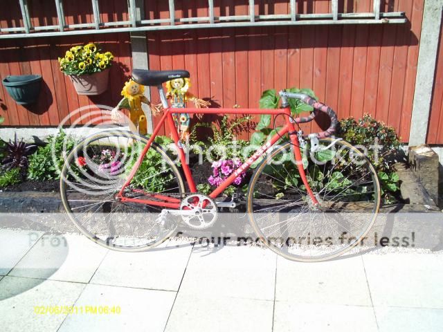

This project was a bit of a blind/impulse purchase I made with some tax rebate money, the picture below and a very basic description wass all I had to go on.
Anyways i took a chance and it arrived in a big box from Staffordshire.

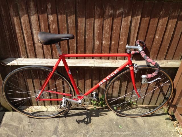

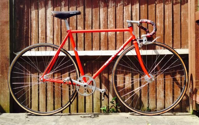

So I reassembled from delivery to check what worked and what needed changing, what compents were fitted.
It rode lovely and from its dirt and cobwebs had sat for some time.
I grabbed a picture, mid strip down.

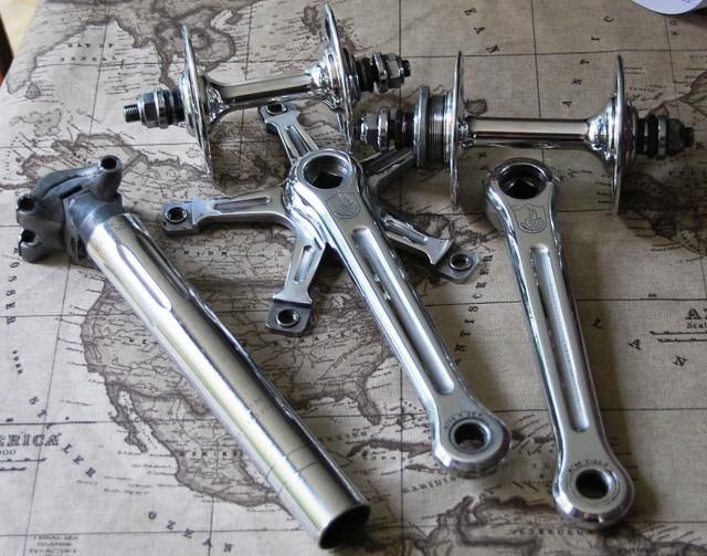

Had some old Campag parts I was looking to get polished but found a guy in London who offers hand polished Campy parts on an exchange basis. So went up with with some well used parts and came back with these....

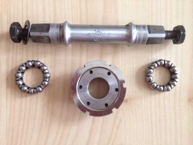

Dad had this lightly used Campy Pista BB in the parts garage but it is missing the DS cup, so on the lookout for a English thread, thin walled cup.

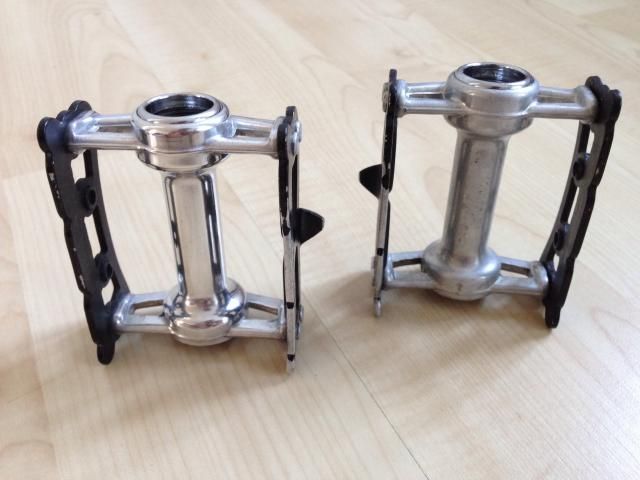

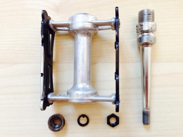

Now I dont want it to just look pretty but I want it to run well too. So stripped the pedals and hubs down, deep cleaned the races, cones and replaced the bearings with high grade balls and Dura Ace grease I had left over from an old NJS build.
The rear axle threads were damaged so had to chase the cone off with an old lock nut and find a new axle.
Also had a go at polishing up the pedal bodies while they were stripped using 3 grades of scotch pads, a polish with Belgom and sealed with Renaissance wax. Came out pretty well I think....

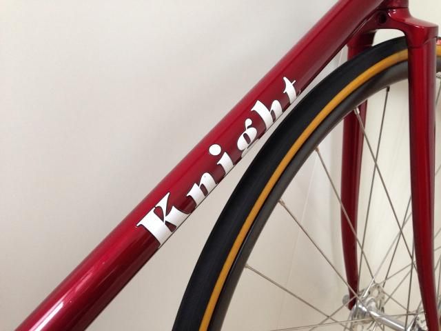

Frame was painted by Jon Aston at [http://www.chickensframeemporium.co.uk/](http://www.chickensframeemporium.co.uk/) really happy with the outcome.
Opted for a metallic burgundy which is hard to pick out unless in direct sunlight, Jon did a great job as did H Lloyd in creating custom colour decals to suit the frame.

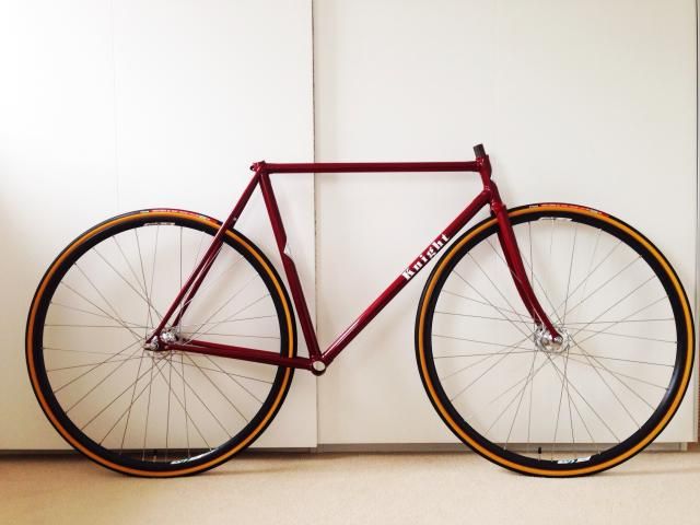

Wheels are also finished, fully serviced by me and laced by Anthony and Richard at True Wheels using stainless butted spokes. I fitted Vittoria Open Corsa tyes to finish off.
Waiting on a BB cup which went missing and then i can assemble the final bike.
