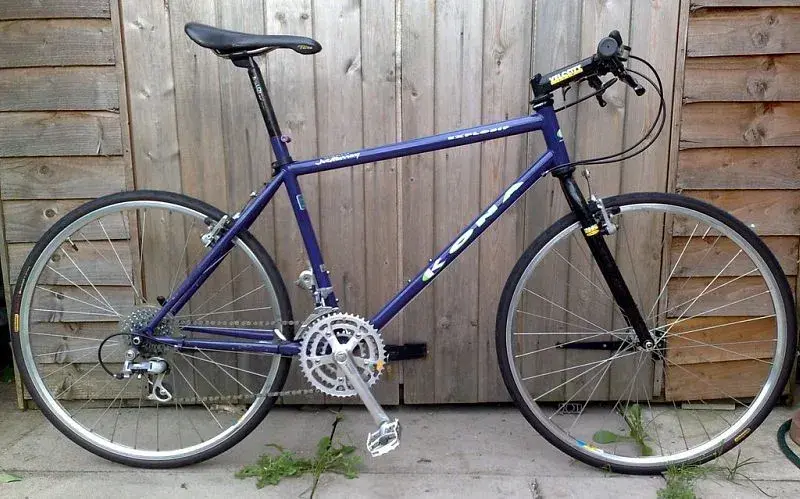

Mostly the sticker is towards the top tube, as in the example shown below, but if this is an Explosif Pro, I believe it would have been painted in the US and that could explain the different practice. Albeit all the Explosif Pros I have seen had the sticker at the top, but custom can mean variations.
The other thing about Explosif Pros (and I have no proof of this, it's just observation and conjecture), is that they are usually believed by their owners to be 92 bikes, but they all have 91 frames. i.e., they have the braze-on seat clamp, as opposed to the removable clamp that all other 92 frames had. So I would have an open mind as to whether your bike is a 91 or a 92, but it's a 91 frame either way. If that makes sense.
So far as I'm aware, the lower-end frames were all built at Giant's Fairly works right from the start, so all have F numbers. Early Explosifs have T numbers, T for Taiwan, and I don't know which factory they were built in. Around the time of your bike, they gave the Explosif contract to Fairly also, so your bike could be either a T or an F. As an example, F911 0289 is a 92 Explosif Pro, so it would be interesting to know whetheryour number resembles that.
