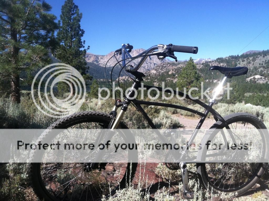

Think that, all in, this has been one of my favourite all time retrobike threads. Love what you've done, how you've done it and the fact your riding the wheels off it! :)

After having watched this thread from a distance, I feel I have to may a comment now that the end result has been reached. I have to admit that I'm not a great fan of building bikes (or motorbikes) out of parts from diferent eras. This mainly down to the fact that most of these builds are not very good! Especially the motorbikes, but that's another story.
However, what you have created here looks so great, and is so appealing that if it were available as a new bike, it would be the only new bike which I would consider buying!
Simply brilliant, well done!

Thanks. With builds like this it is important to have a plan and a vision for the bike. Never start a build without a specific goal. I have made that mistake in the past and it ends up getting costly. I agree with you, some bikes you just don't mess with. I have seen some truly rotten things done to some really cool bikes. Just go to Ratrodbikes.com. Some of the builds there are brilliant and many of them are truly horrible. One guy on there took a 38 schwinn Excelsior that had really decent original paint and drilled holes in it to make it a whizzer. To me if you want to mod an old frame you pick one that is solid but not in original condition, like the rusted out POS this thing started as.
