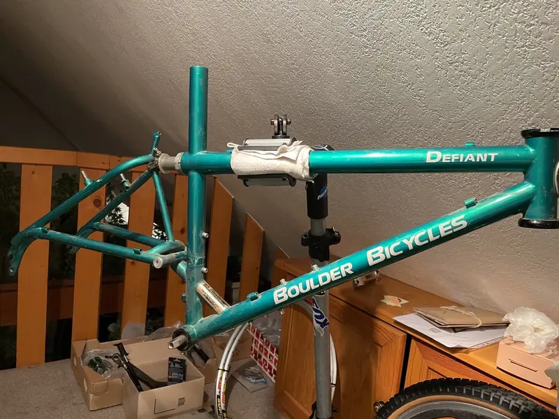

Not sure of the year, serial number don't help and even if the initial build is with 93-94' parts, the decals look later so I would allow myself to put some cool newer parts on it.
Arrived at home, I stripped it for a good clean and the fun can begin...

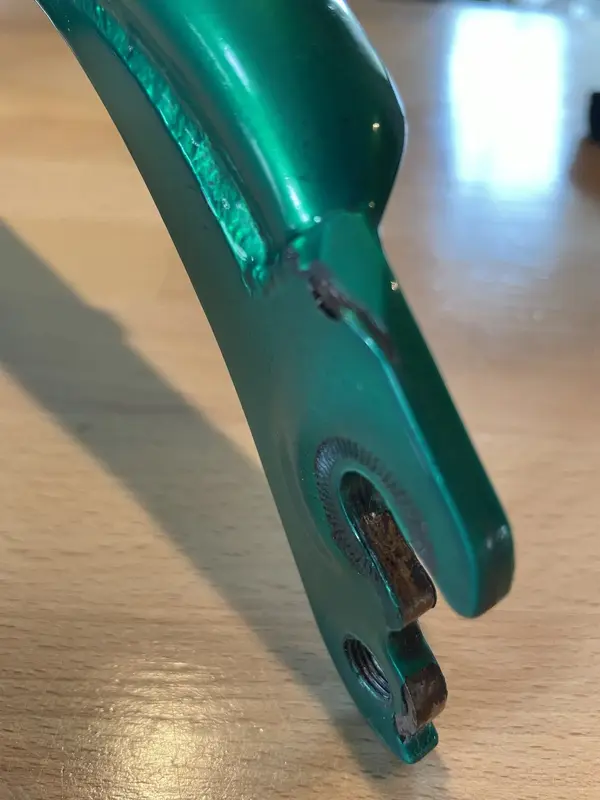

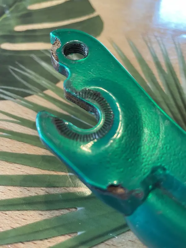

Very good condition... No crack or dents and paint in a good condition apart on right dropout, but in the same time I've planned to repaint it, so...

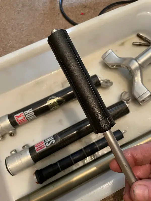

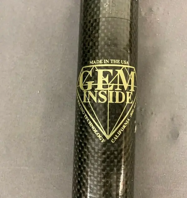

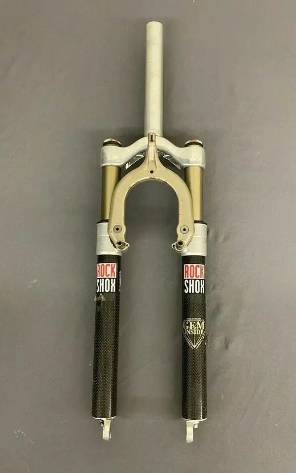

One of my funniest time (for the moment) of this build was when I received the fork I planned to set on the Defiant. A nice Judy FSX with a Risse Gem cartridge...
What I didn't know was that I had bought a nice specimen of Frankenfork... It's not the correct brake arch I know, but I prefer a clean Judy one than a cracked FSX one. Also, I dont know if I go to a polished or frame colour matched paint for it so, I take my time. But if someone had a Styff Shock Bone in his spares box, why not...

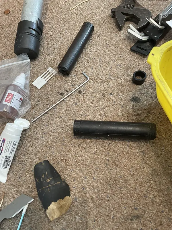

Suuurpriiiiiise !!!! A nice genuine plastic cartridge instead of the Risse...

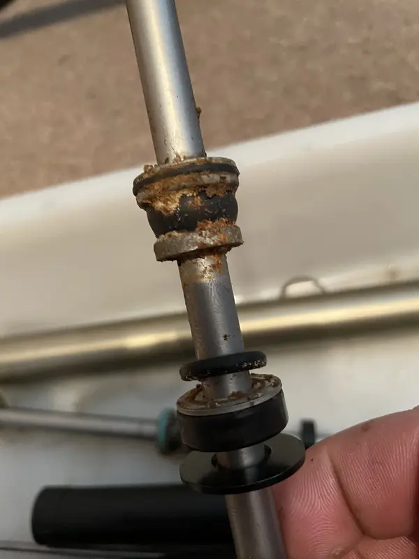

Obviously, some MCU's were melted but they are already replaced advantageously by SRP springs like cartridge internals with SRP Judy service kit... Thanks to @kokies !!

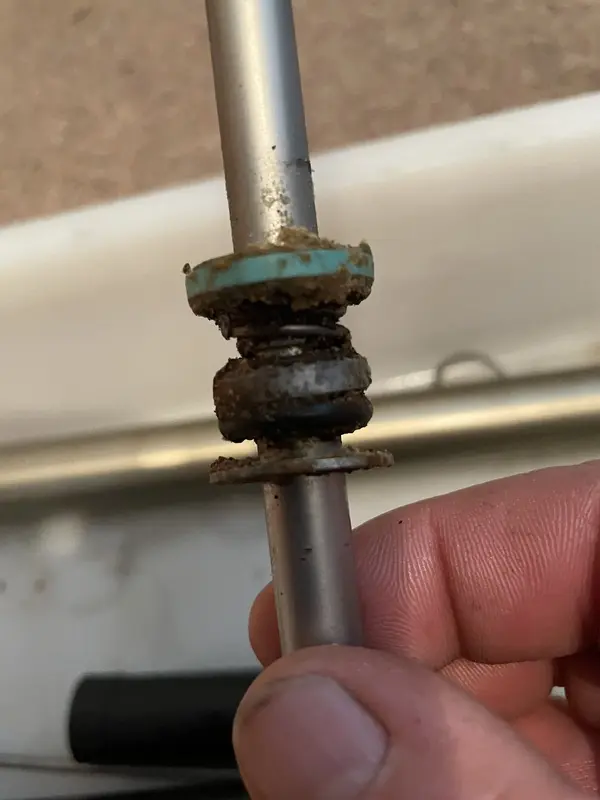

The cartridge hadn't seen any oil between long time ago and was completely dry. The shafts coated with a nice mix of dry grease and settlings...
The other find in this surprising fork is an another empty cartridge... Maybe I buy a secret prototype ???
