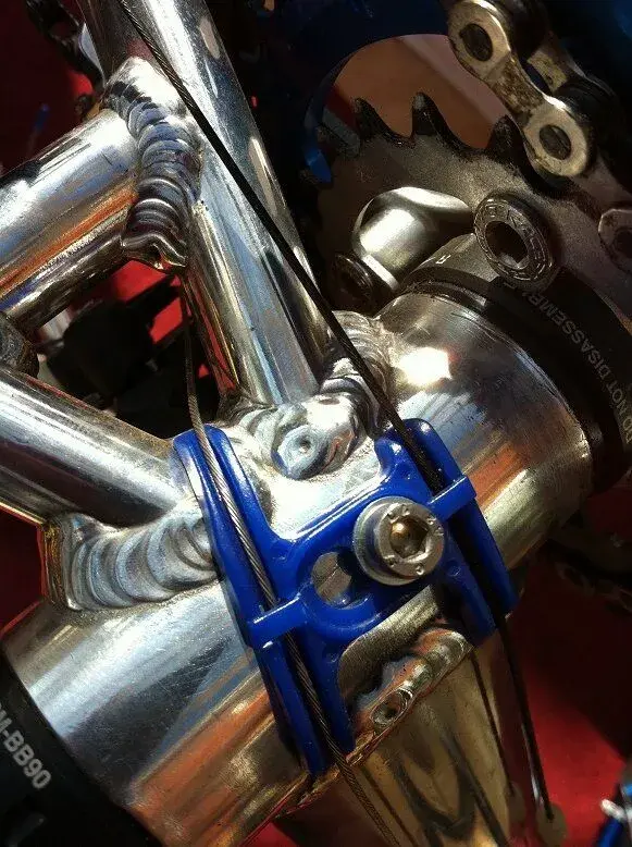

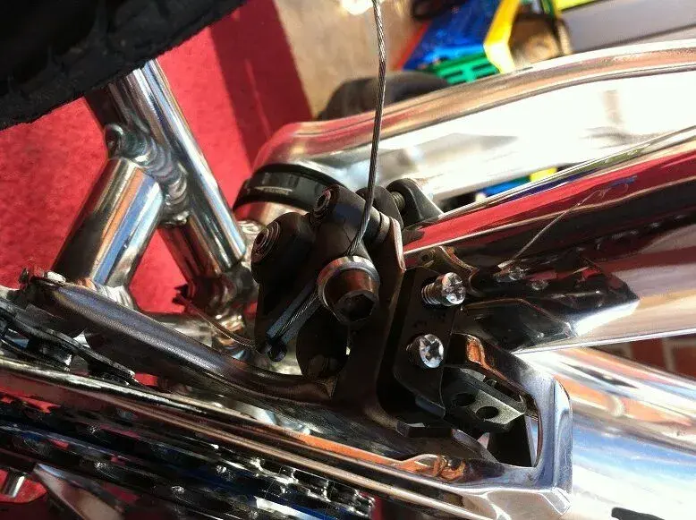

I used a M952. Just looked close and no cable rubbing on mine. Will post a pic very soon to show routing for mine. Make sure guide is over to drive side, that should avoid the rub. Does for me anyway :-)
I've been looking at my other Zaskar builds (3x 1997) and all have been 'traditional' style bottom pull LX or XT. The cables routed without issue.
gtRTSdh said:
I assume they left the shops rubbing the frame as in our pictures, I don't understand why the tubes need to meet in the centre of the BB in the way that they do.
It maximises contact area, strongest possible join. Doubtless not a problem when the correct OE spec mech was used, so why not?
Our chaps frame appears to be in excellent condition with no evidence of cable rub/gouging from the original mech and cable run. Occam' s Razor, original mech didn't cause rubbing, we have the wrong mech. Be nice if our chap does come up with a solution ( I favour etype mech myself, avoids this grief and doesn't damage the frame finish with the call).
Thanks! That’s perfect, I think your cable guide sits slightly further over than mine, I will post up a picture when I get home for future reference.
I will look for a new cable guide on ebay :)
Thanks for everyone’s help.
Dan
Chopper1192":28e8xcwd said:
Could it be that simple? Awesome!
I think so!
The pic below is my cable guide, its clearly more center than tonedeaf101's.
Seems stupidly obvious now i know :facepalm:
Thanks for everyone's help getting to the bottom of this.

Is your guide not adjustable? Id get a new cable guide if not. The one I got was only a few bob, from chain reaction and can move from side to side. Or cut a slot in your existing one. That wire will make mincemeat of your tubing in no time.
