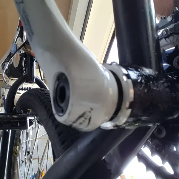

I have to change a bottom bracket on a C16r. It currently has a Hollowtech with an XT crankset. I am hoping to go back to a square taper - un72 - with an older crankset with shorter arms - hence the change.
Will I need two different tools to change the Bb's?
If so, what do people recommend? I don't want to waste money on something I'm not likely to use very often, if again.
I've changed cranks, but not a bb before.
Any advice would be appreciated.
Basically, yes. You’ll need a Hollowtech II outboard cup spanner/tool and a standard Shimano pattern splined internal cup tool. Easily available at least.
