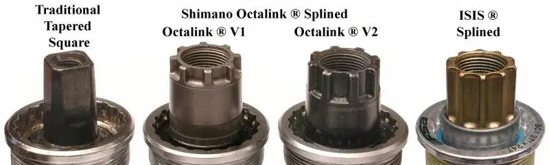

You can fit the two versions of Octalink, as well as the ISIS type:
and also, the External Bottom Bracket technology, like Shimano's Hollowtech II:
Personally, I would use Square Taper.
