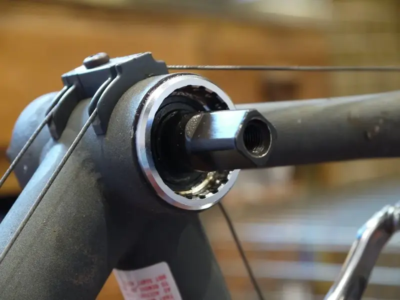

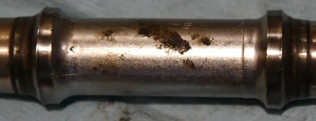

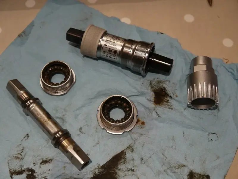

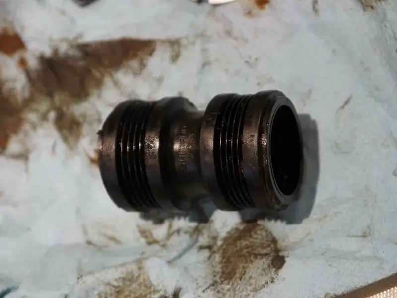

A visit to my friendly LBS and a lend of their correct BB tools and the old BB came out in a matter of mins! Very fortunately it was not fused in and the threads all looked nice and clean no corrosion. Upon inspection of the spindle I saw straight away that both surfaces were badly pitted...I didn't bother checking the bearings themselves but a brief glance at those showed they were far from smooth and had rust on aswell! Also a plastic sleeve was also in the frame (see pic) it had to come out tho so that the new BB would fit.
So I got a UN54 and the correct tool and went home quite pleased with myself...

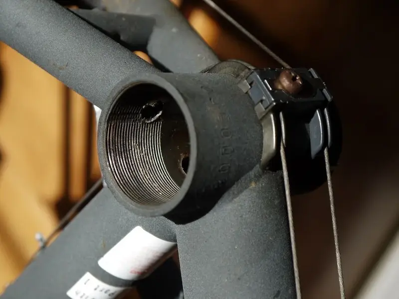

Then it came to fitting it....

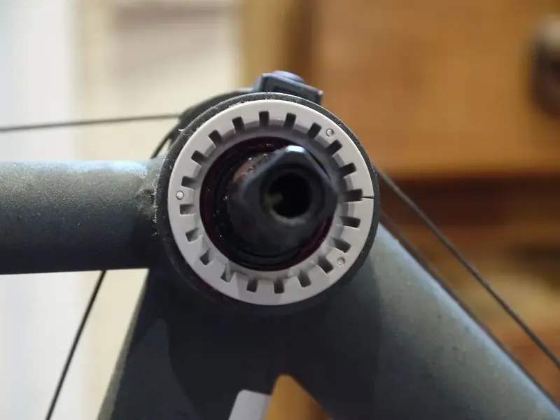

...Drive side went in fine, then in the last couple of turns on the non drive side there was that tell tale click sound of plastic snapping! :evil: Yup you guessed it the non drive side cracked!! Arse!!
So will it be ok with the crack? He asked hopefully or will I have to find a replacement plastic bit?

My UN54 has been in the frame for a couple of years with a cracked plastic cup and hasn't caused any problems. The cartridge itself keeps everything together and the plastic cup only holds it in place within the frame so it'll probably be fine. Leave it in and see if it actually does give you any problems before worrying about it.
It's a shame you didn't get the UN55, it's basically the same cartrigde, but now comes with a metal cup.

That's fair enough. Provided the whole assembly is held solid within the frame and can't move about I think it'll be fine. I've got a UN54 in one frame and a UN72 in another and they're excellent, both as smooth as the day I fitted them and have easily outlasted any of the separate cup and cone types I've had fitted to road and MTB frames over the years.
Sadly they've discontinued the UN72, I don't think the bearings are any better, but it was about 50g lighter.
I wouldn't worry and would ride it...you can always ask in the wanted section for a un54 cup in plastic or metal..someone might have one spare?
Its in solid I think I was just being a bit brutish with my fitting! But in my defence I had like a 1mm gap between it and the frame and I was gently (kinda!) persuading it in the last mm when it cracked...Feels lovely and smooth tho unlike the the old one. Not had the chance to ride it yet tho so we'll see!

the cup just carries the sealed bb body and keeps it straight. if it's nipped up well then you shall have no bother.
