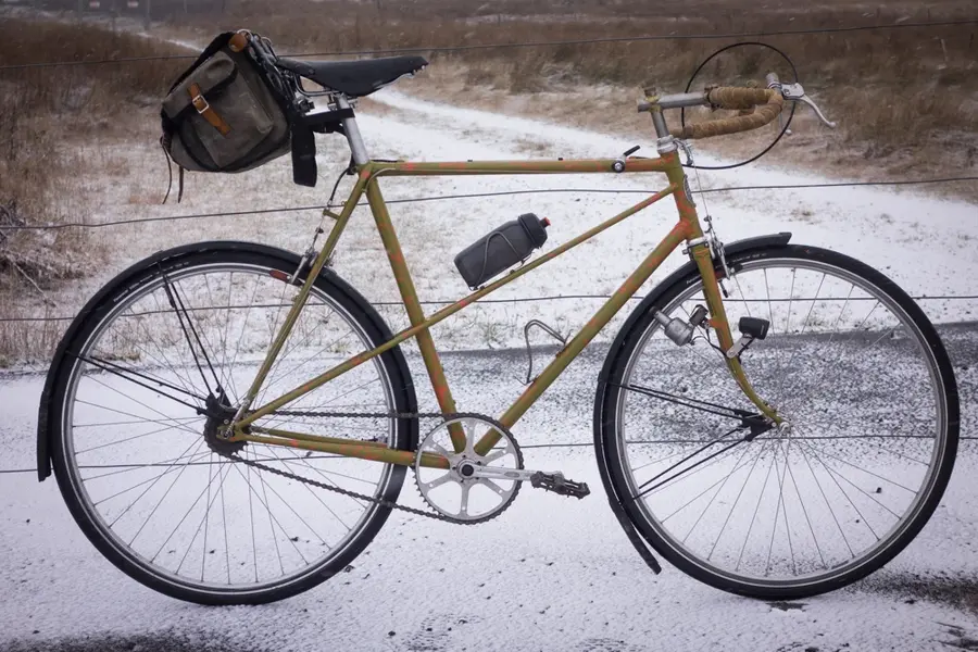

I have just given my 1961 Flying Scot a bit of a revamp and one thing I've added this time is a bottle dynamo.
I did a brazed on mount on the fork and everything but, its really disappointingly bad!
Admittedly today's shakedown ride was wet, snowy and pretty much all at sub zero temps but what good's a dynamo if it doesn't work in these conditions right?

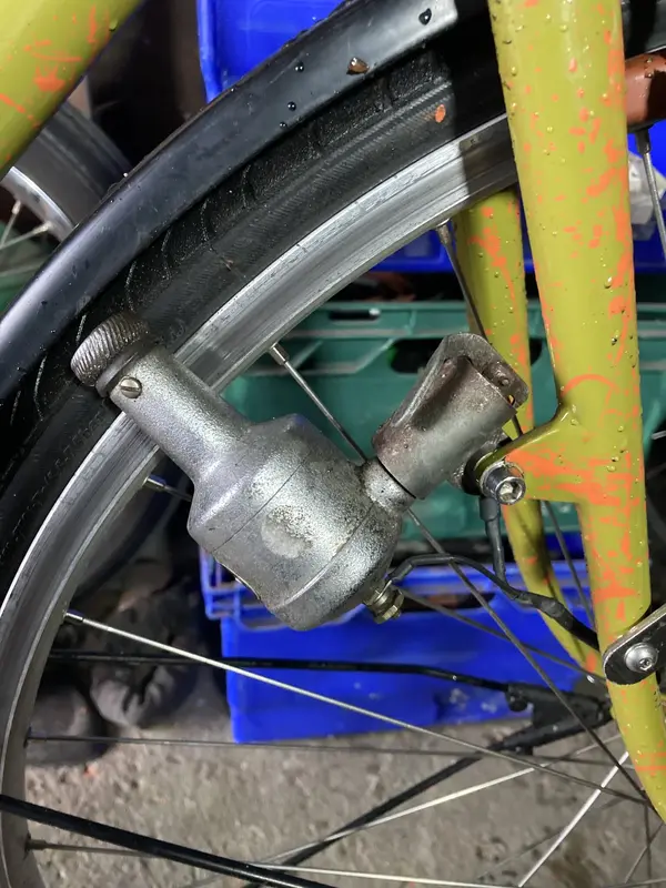

The dynamo is a Lucifer Baby 800, chosen for it's name rather than it's performance. At the start of the ride it was running alright but when I got the first bit of descent it started slipping. At that point I was able to push it into the tyre by hand and it ran alright...for a while. Before long I was noticing that even pressing it into the tyre wasn't working and I was worried about wearing the tyre away so gave up on it.
As far as I can tell the dynamo is at the important 90deg to the tyre but I'm not sure if I have it set too far from the tyre when pulled out maybe?

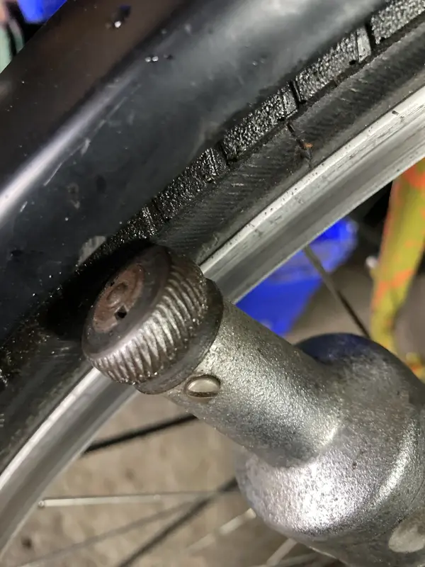

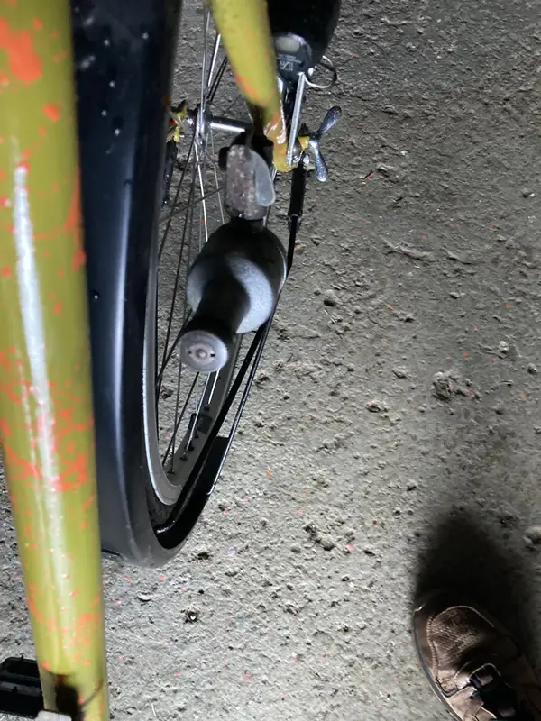

Some more photos of its positioning.

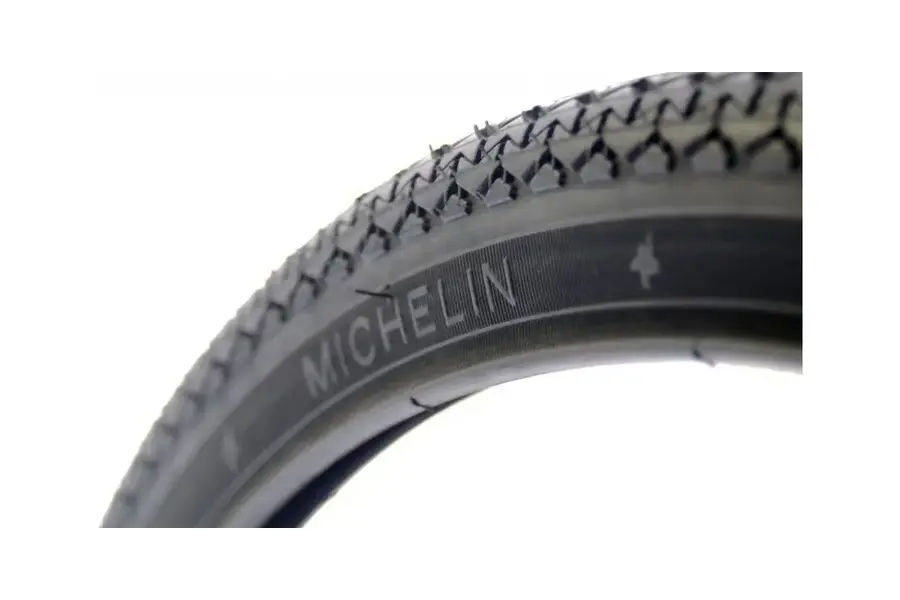

The problem, per se, is not the dynamo, but the tyre. Back in yonder, tyres had side walls to help.
The Michelin World Tour - a kind of reference since we were breast fed in aged product continuity with a side profile aimed to help the bottle dynamo. I have sold several vintage bottle dynamos, and I'm pretty sure it's the low distant urban environmental crowd that see the the appeal of them these days in more of a city type bike.
Yeah I have noticed dynamo tracks on tyres and was aware these do not have them.

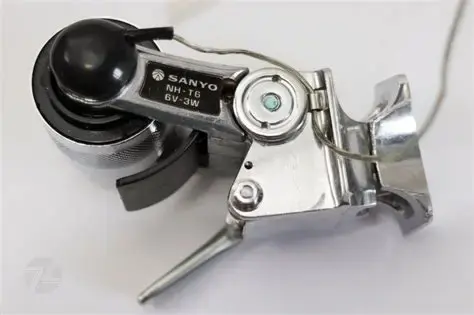

The old Sanyo was a big hit BITD. A more complicated wiring.
But to to be honest, for practically, all these systems are now obsolete if you really need to light your way.
