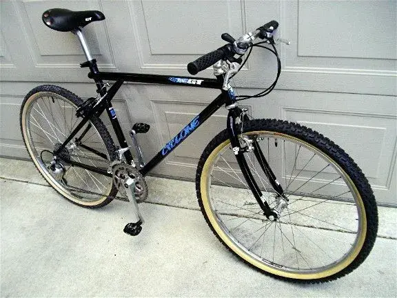

1991 1st Year GT Cyclone...Just finished today.
First off I want to thank Mike for making this build-up possible. Most of you know that GT's are my gig so I was naturally excited when this one became available, especially one in such good condition ....new. I didn't do any shopping to build this one up. None. Everything you see on it was in the bins or hanging around. I debated heavily going with M900 XTR but it is a 1991 frame so I stuck with XT 7 speed. Many of the parts are NOS items that I picked up for future builds. I'll post some additional pics in the appropriate thread since there's a limit in this one. Here's the spec, Enjoy
Frame: 1991 18" GT Cyclone frame. Fillet Brazed True Temper AVR Tubing 73mm BB, 1-1/8" headtube, U-brake in the rear
Fork: NOS GT 3D Chromoly unicrown DOM 03/1991
Headset: Chris King NoThreadSet Silver
Cable Hanger: Tioga threadless 1.5cm Drop silver
Stem: NOS Tioga Threadless with internal clamping device polished
Handlebar: NOS GT Aluminum 560mm
Grips: NOS GT/A'ME Anatomical vulcathane rubber black
Brake Lever: NOS Ritchey Logic Black/Silver
Front Brake: Ritchey Logic Cantilever silver
Rear Brake: NOS GT Deore XT w/U-II flexguard
Shifters: Shimano Deore XT 7-spd Top Mount
Front Derailleur: NOS Shimano Deore XT
Rear Derailleur: Shimano Deroe XT RD-M735
Bottom Bracket: GT Titanium with alloy cups 73x113mm
Crank: GT Low profile CNC w/46/36/24 Shimano SG-X rings
Cassette: Shimano Deore XT CS-HG90 12-28t
Seat Clamp: GT machined alloy with alloy QR
Seat Post: Ritchey Nitto Force Directional 26.8 (was black)
Saddle: NOS GT regal type
Rims: Araya RM-400 Pro 7000 T6 32 hole
Hubs: Frt/Rear Shimano Deore XT HB-M730/FH-M735
Skewers: GT Titanium w/alloy QR
Spokes: DT 14/15 DB Stainless Steel
Tires: Ritchey MegaByte ZMax K's 2.1 front, 1.9 rear
Pedals: NOS Shimano Deore XT PD-M737
enjoy...I know I will.
