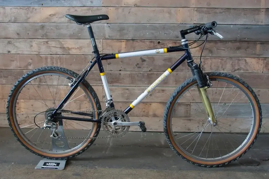

Thanks again for the reply....are all bontrager race lite frame measurements C/C unless otherwise noted?...is this your race lite?
Is that a Race Lite?
I have a very similar looking Race OR - and the headset is 1" and I have a Tange Levin on it.
Yes, centre to centre. That looks like the same size as mine, and in my favourite film colour!

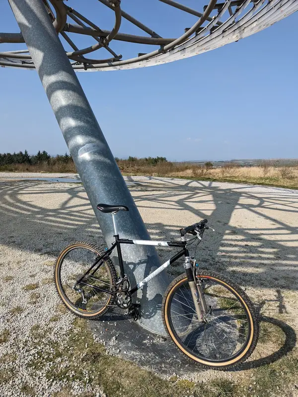

This is what mine looks like now:
