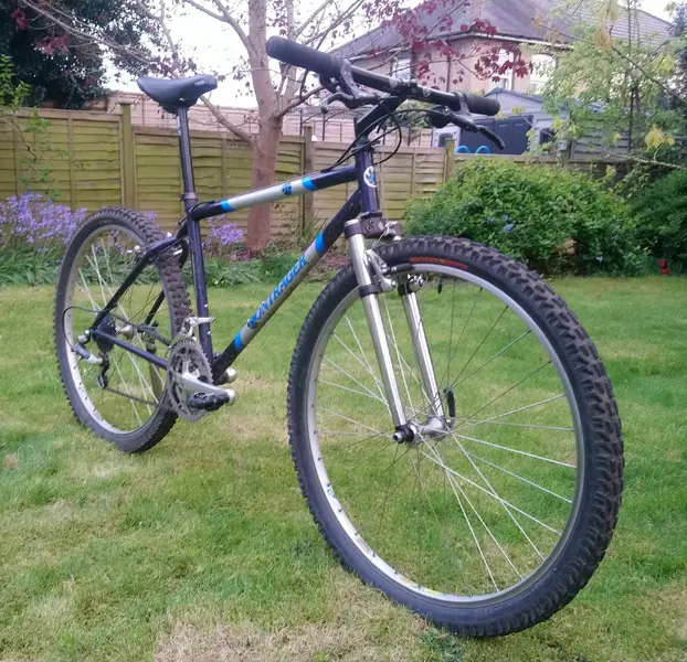

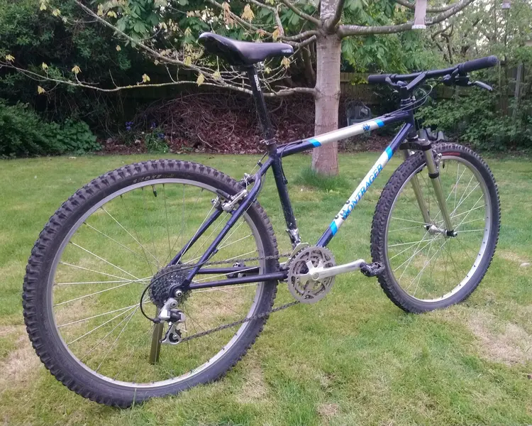

Have you tried moving up the crown , leaving more of the legs, messing around w/ the head angle? Just because you can. It would change the handling. I would do it... just to see what happens.
If you look at this you will see that if I move the crown up it won't be overlapping the full fork leg on the inside. I don't think that is how it was intended or particularly safe. Moving down would probably be alright but not up. 👍 😁
I see 0.5 to 1cm to play with... Yours is a mag21 corrected frame, right?

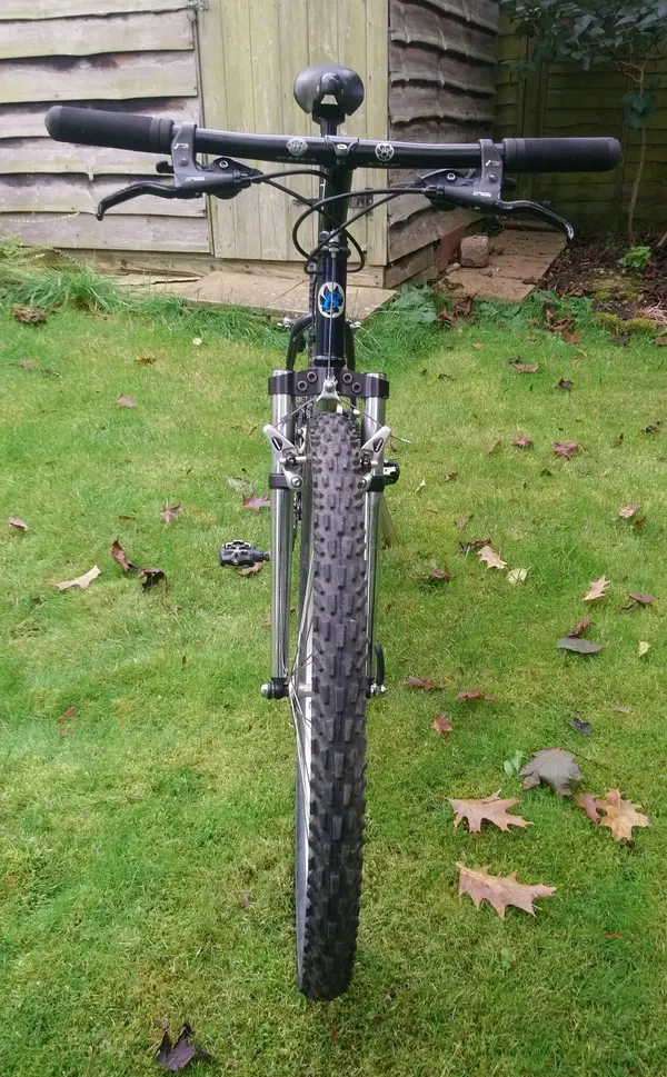

PS: NIce break straddle cable position.
It's staying as it is, full leg/crown overlap is more important to me than taking 0.4° off the head angle and raising the bb by 3mm. Which really won't be very noticeable anyway. It's absolutely fine as it is! 😁
