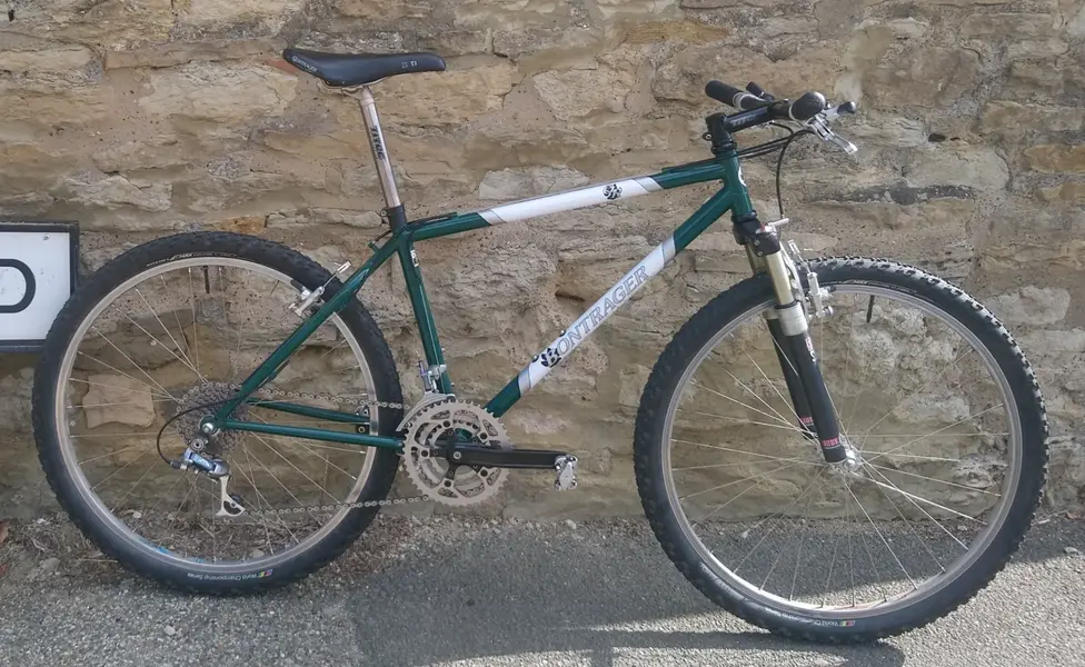

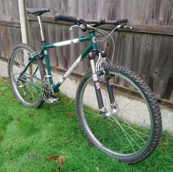

Bontrager Race Lite
Of course I've been faffing about with this again. I think it's just a Ti Flat-Tracker away from forever spec* (I have one, it's been on the bike but it lives on the Ti Lite), been using it a fair bit recently and it's just a bloody brilliant thing. 22lbs of comfy, speedy, whippy steel. 👍 😁 _20250814_211718.webp
* 😂 Yeah, I know, not sure I believe that either but it's pretty bloody good as it is at the moment. 🙂
Spec sheet.
Frame: Bontrager Race Lite Medium
Fork: Rockshox Judy FSX, SRP brace, Bontrager short offset crown
Headset: Tange Seiki Technoglide 1" threadless
Stem: Titec T-slot steel, 90mm, 0° rise, Ti bolts
Handlebar: Titec Flat-Tracker aluminium, 640mm, 11° sweep
Grips: ODI Attack
Barends: not on my watch!
Brakes: Avid Tri Align
Brake Pads: Aztec
Brake Cables: Shimano
Cantilever cable hangers: Avid Tri Dangle
Brake Levers: Avid Speed Dial Ultimate
Shifters: Suntour XC Expert thumbies, 8 speed, polished brackets
Front Derailleur: Shimano XTR M900, 28.6mm bottom pull
Rear Derailleur: Shimano XTR M910 GS
Derailleur Cables: Shimano
Cassette: Shimano XTR M900 12-32
Chain: Shimano HG-71
Cranks: Raceface Turbine, 175mm 110/74 bcd
Crank Bolts: Middleburn self-extracting
Chainrings: Shimano XTR M900 46/36/26t
Chainring bolts: ID aluminium
Bottom Bracket: Raceface Taperlock Titanium 107mm
Pedals: Shimano PD-M747
Hub Skewers: Halo Allen bolt
Rims: Weinmann Bontrager BCX Red front BCX Blue rear 32h
Hubs: DT Hugi first generation 32h
Nipples: Sapim Polyax brass
Spokes: DT revolution
Tyres: Ritchey Z-max Evolution 26x2.1"
Tubes: TPU ( 56g! cheap aliexpress jobs my mate gave me cos he bought the wrong size, I was/am sceptical but so far so good)
Saddle: Bontrager Velo Titanium, perforated leather
Seatpost: Titec Titanium, 350 x 26.8mm
Seatpost Binder: Bontrager cnc
Weight: 22lb 2oz or 10.03kg
