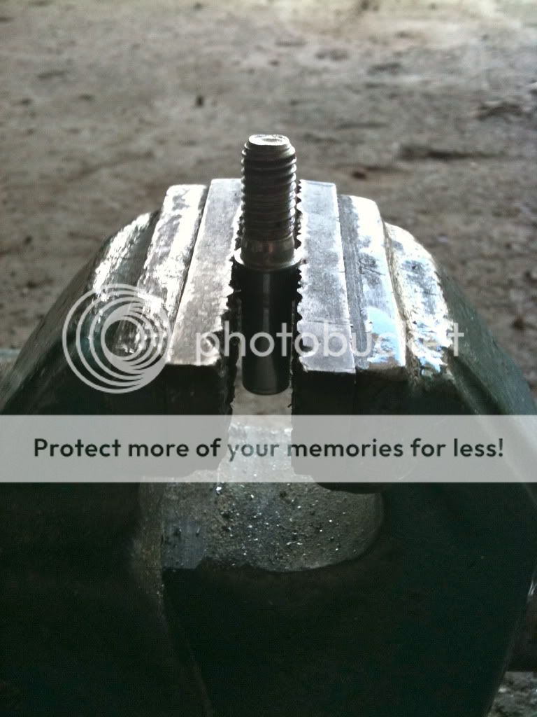

First you need studs with 8 mm threads as shown here.
Then you fasten them to a vice.

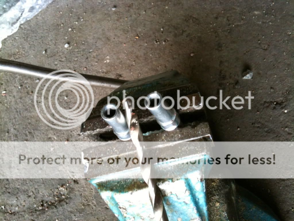

After fastening them you drill out the inner threads. First I used a 5,5 mm drill, then I used a 6 mm drill.
Then you fasten them with the outer threads up. These won´t go in the frame, a long bolt will. So off they go with the help of a saw.

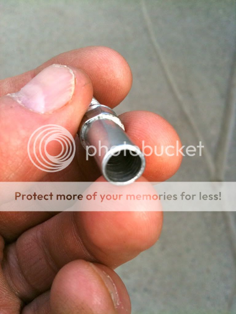

After sawing the threads off it will look something like this.
The end result! Now you can put the brakes on if you´ve lost the original studs.
Hollister said the original studs were alu and these are steel, but I´m really pleased with the results :D

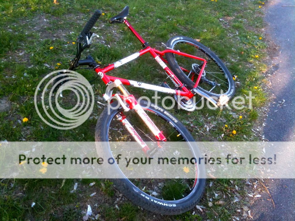

First testride, with my kid.
Didn´t get the front mech totally right, but enuff so I could ride it.

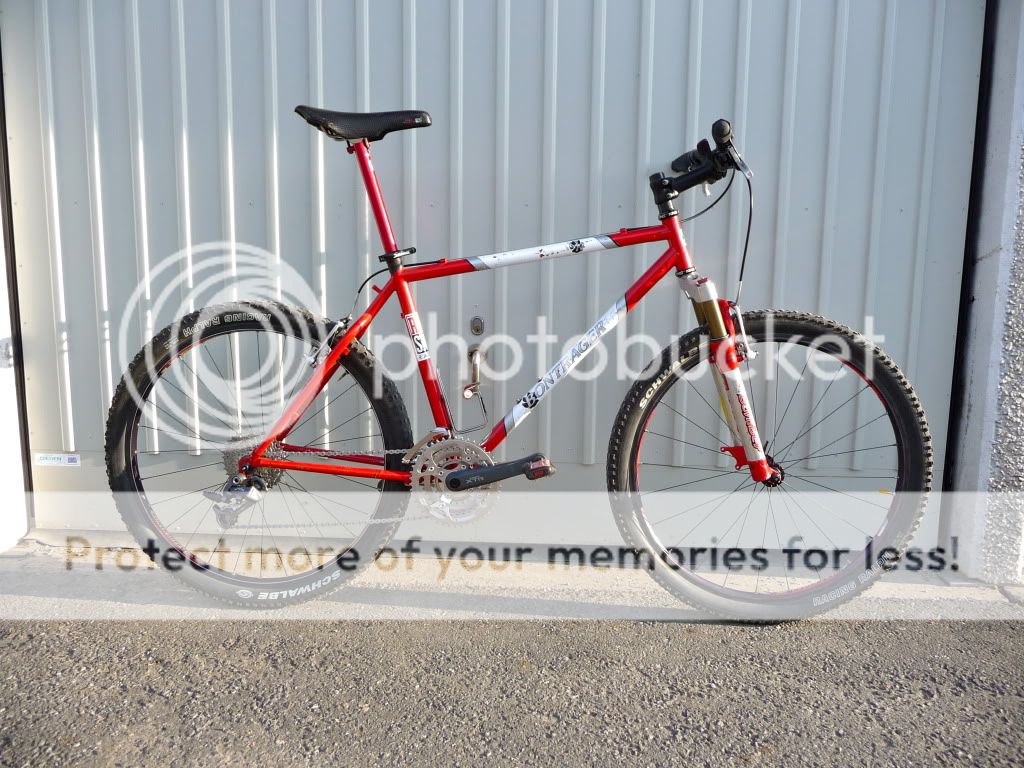

I´ve really tried my best in building my dreambike.
First time builder, but I took my time though ;)

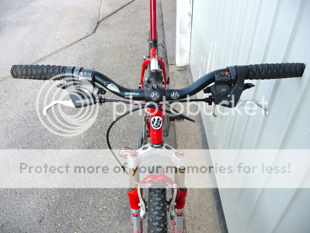

I haven´t really tested it in anger yet.
It got finished last night, and I´m not really pleased with the front mech adjustment.
When I get to my usual trails, it´ll be interesting to see the difference between the Marz and the Bonty rake on the Judy I´ve got on my privateer.
I can tell the weight diff though...
