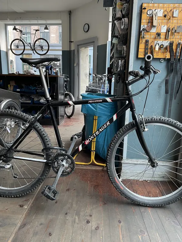

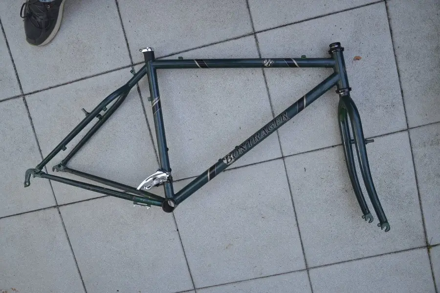

Been looking for a new project, and this one came up in Germany for the right price:
The seller claimes it’s a 1996, but there is no canti hanger, might be a later but will have to investigate. It’s built up whit a mix of xt and lx parts pretty close to the original spec but with avid v-brakes. I’m in doubt if the forks are original, will try to measure the rake to check.
The plan is to build a bike to ride on gravel paths with a child seat so it’s not gonna be 100% period correct, but will keep it close.
Better pictures will follow soon

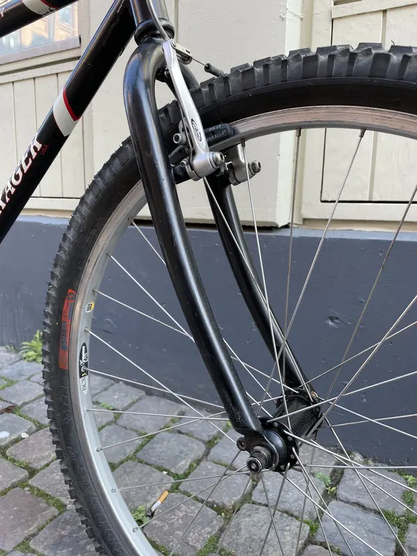

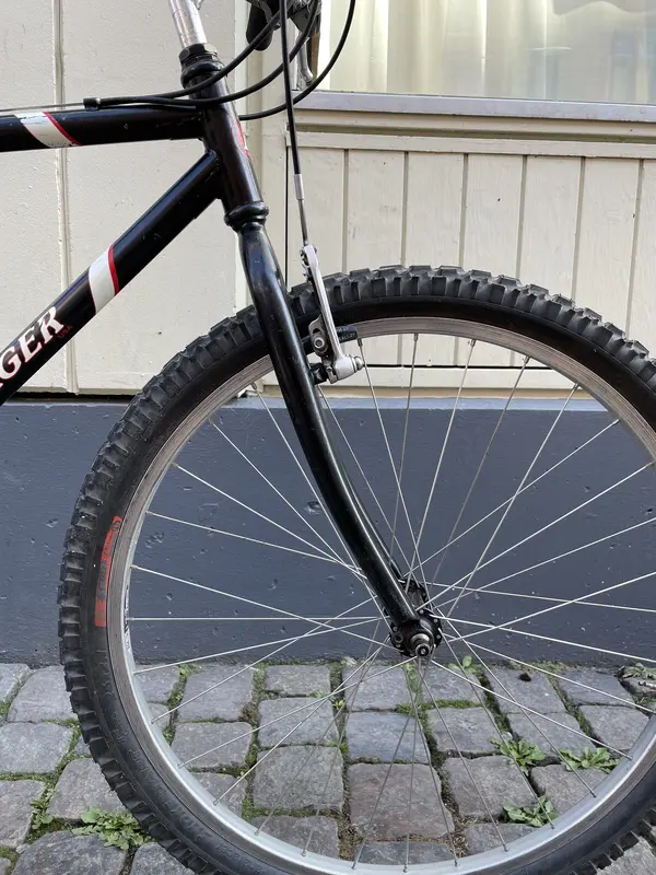

The forks seams fine, but I'm really wondering if thy are original, to me thy look a bit short. I'm trying to find information on the original bontrager unicrown forks, did thy have 1.25" rake (like his rock shox) and length for suspension correction or were thy just standard off the shelve tange forks?
I looks here on rerobike and in the old catalogues and on the old webpage (go check it out: Bontrager.com ano 1997) but no luck, if any one have info on the i would be amazing.

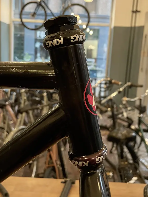

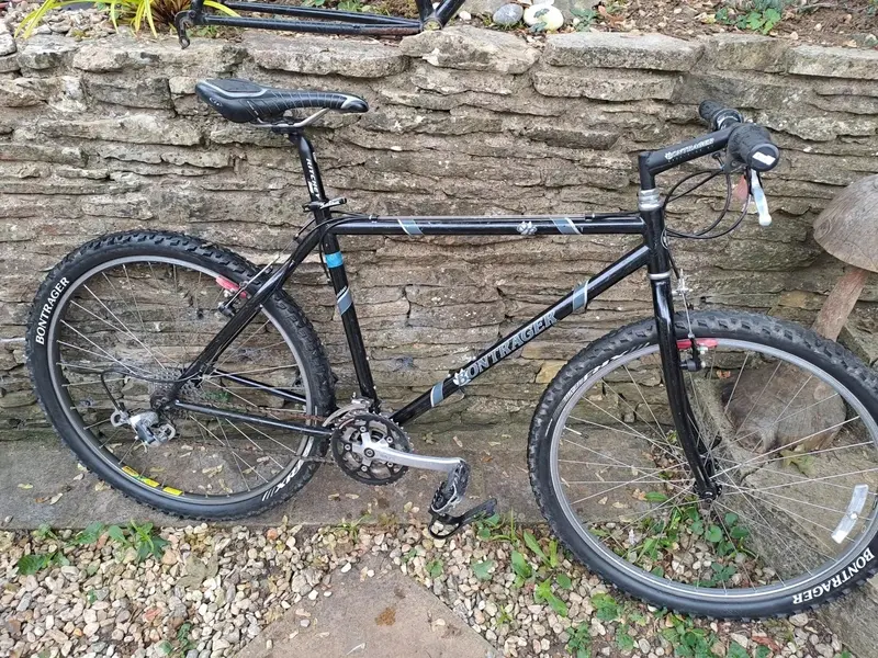

Here is one to compare: IMG_1002.webp
The crown seams to look different and the brake studs are not the same - but I’m not sure if it means thy are a bad fit.

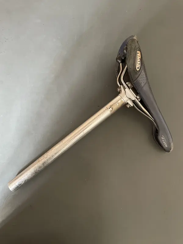

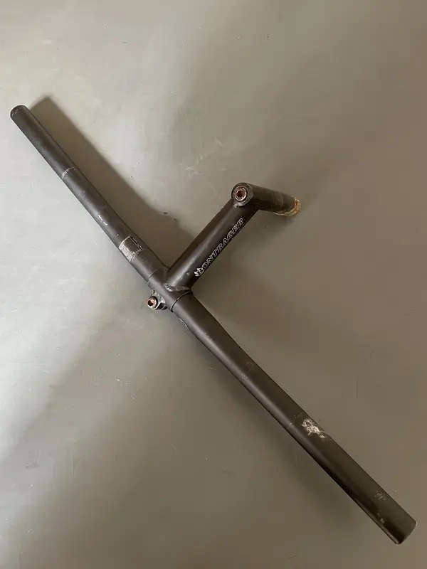

I will properly end up doing a total rebuild but the bar, stem and seat post are the first parts I will have find a replacement for, I have some old bontrager parts from a privateer I’m building for the wife (yes i know :)) - thy will do, for now but I will have to find something more relaxed down the road. Maybe i will try see if some one will swap a salsa to one with some more angle, else it has to be a riser bar.

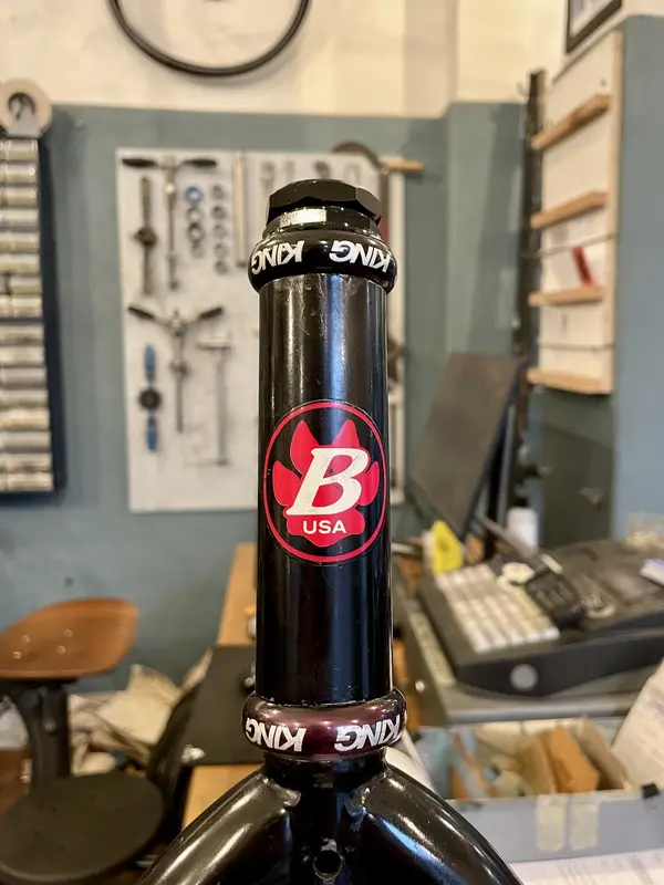

I also have the original silver tange headset i think it looks nicer.

Tested the flat bar around the block this morning, is way to aggressive for my plans whit this bike. So fitted a Ti high riser i got from a fellow retrobiker. The stem and seat post are spot on!

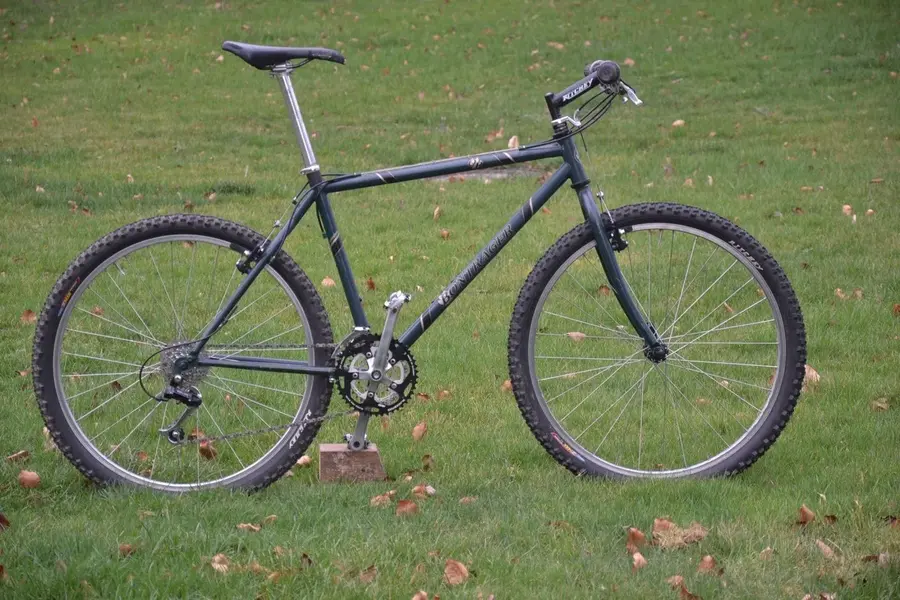

I think a red bobike mini will look great it kind of matches the decals :)
I ran a "wee-ride" bike seat for a while. Still got it, but now the kids are a bit older I may switch to something similar to the one you're considering
That looks so hyggeligt!
Did i work well? Looks like a smart mounting system - the bobike/yepp's that are common in denmark are mounted on the stem and im thinking that this affect the stearing less - I'm not gonna race whit my kiddo, but handling is still important
Yes, worked well, the bike handled pretty good with it, I managed some decent off-road riding!
Only slight downside is that it gets in the way of your knees slightly if you don't have a long top tube. Still comfortable enough, but you have to splay your legs a little bit.

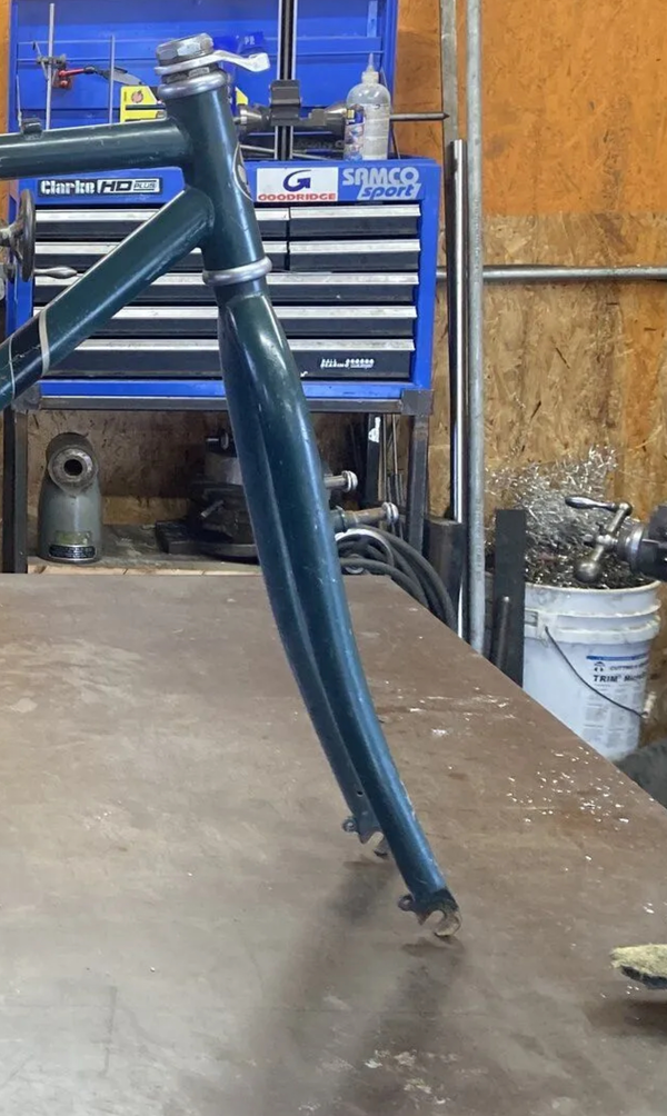

I'm trying to find good information about the Privateer forks, but it seams hard. Been writing a bunch of guys here, to get some measurements but thy don't seam to be very popular, most retrobikes have replaced them whit suspension :)
The two mane questions is what’s the rake and A-to-C measurement, my guess is 1.25" and 410mm to match the suspension.
Here is half a dozen pictures of forks:
