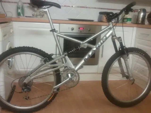

Slighty later bike, but this has 120mm forks on it. I've had a new rear shock mount fabbed though so that it also runs a 220mm shock and again has 120mm ish at the back.This also lifted the back end to correct the steering angle. Its a tall bike though, look where that BB is before sag.
Really should build this back up at some point...

:shock: Nice. I think I'll stick to around 100mm though :-) I want a little more travel and a bit more plushness. Even though I gave the fork a good going over it's still stiffer than I would like and getting new elastomers is pretty much a non starter. I am going to put one of the Manitous I have ( got two Mach 5 Pro Cs) on a 98 saracen frame I have and may keep the other for spares, but this is my main rider and I would like a bit more suppleness up front, especially after the ride I had last night :-)
