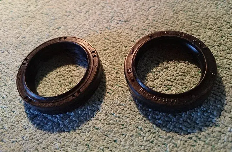

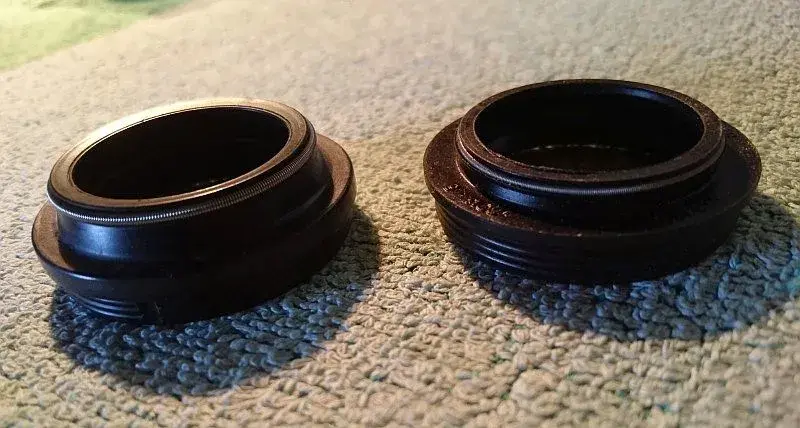

Have a look at this 2 pictures, it shows the dust seals and the oil seals, I found both in 2 versions. Apart from the Enduro replacements I'm wondering what kind of seals had also been produced?
Which are the last and best for Marzocchi 30mm Bombers?
Do any of you can provide pictures about other types of 30mm seals?
What's the current best offer for a kit (2x dust + 2x oil seals)?

the higher ones are made for the cnc arch forks, the lower (least taller) ones for the one-piece (commonly knows as the M-arch) forks.
there is a difference in the outer diameter, and there is less available space in the M-arch forks - that means the newer seals fit the older forks without a hiccup.
It's the opposite from what I've seen, taller dust seal is for newer forks, short one is the older style.
All the original bolt together cnc arch forks I have here have the shorter dust seal that says Marzocchi and a part number. The dust boots interface correctly with the shorter seal.
All the m-arch forks I've seen came with the taller seal that does not work with boots. They are all early two piece m-arch forks, not the later one piece lowers, don't think that matters at all though.
I would tend to trust the later seals just because they are probably a decade newer and are still usable.
I've bought oil seals from the local motorcycle dealer with the same specification as the original Bomber seals. 5 or so pound for a set of 2.

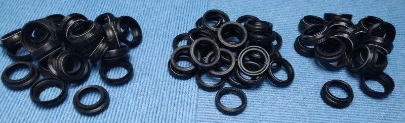

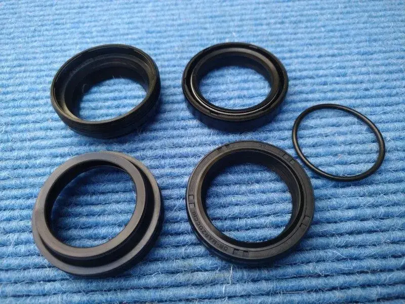

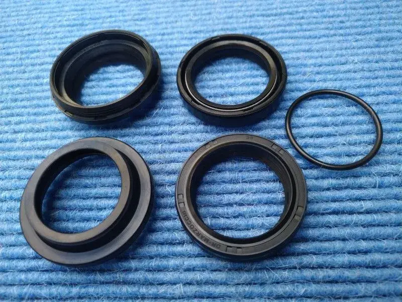

FYI : In the end I did it myself, I just received the information, that my reproduction (both classic and M-arch + Oil seal) has been finished. I'm awating shipping to DE now.
Done. In stock now. o_O
