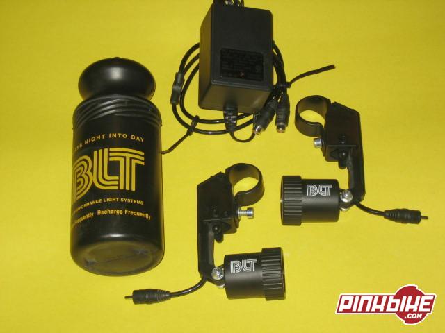

my BLT's (can't remember which model, but bought in 1998) and looked similar to these:
just used a 6v lead acid battery (output forgot) , similar to a burglar alarm battery from maplins. The hard part was getting something to fit in a water bottle.

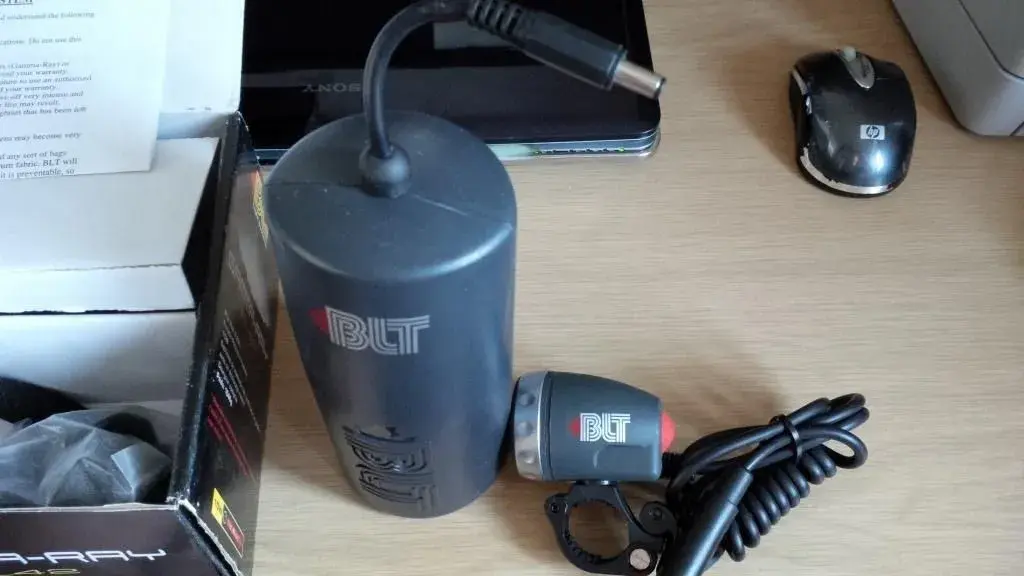

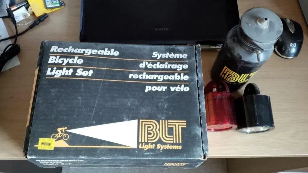

I've got two systems. I've uploaded pics of them both. The black box system at the top is the older, which I recall acquiring whilst I was working at Yellow Jersey bitd - circa 1990. Even then, it was a £120 system, which was absolutely megabucks for a bikelight set at the time! This black battery system, with the switch on the side of the bottle, I think, is probably Ni-Cd based, with a battery inside (which is secured with expanding foam), and glue-gun sealed at the base to get the battery into the bottle to begin with. I've got a feeling that I can recall that one of these bottle batteries was replaced by Evolution Imports bitd and it came back looking like new after the job was done. I'm pretty confident that this can be replaced without too much bother and some time on a Winter's evening.
The newer system (the Gamma Ray) I picked up on Fleabay the other week - the seller was a trade seller, and it appeared to be BNIB and has just sat on a shelf for all of these years. I've got a feeling it's early 2000's as a system? This is by far the more tricky to replace/service as I look at the bottle itself. There's no obvious seal to the bottle itself, so no easy way to cut through and original seal, replace and then glue-gun it - although that might be the best way to do it if I can cut a nice neat circular hole in the base to gain access to the interior. As the bottle doesn't open, I can't see the internal electrics at all - I've no idea if what's in the bottle can simply be unplugged and replaced, or if it's one of these sealed and unserviceable items? Anyone know?
