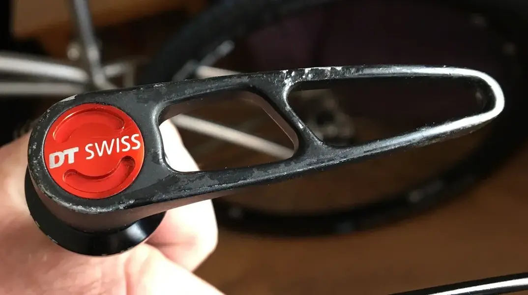

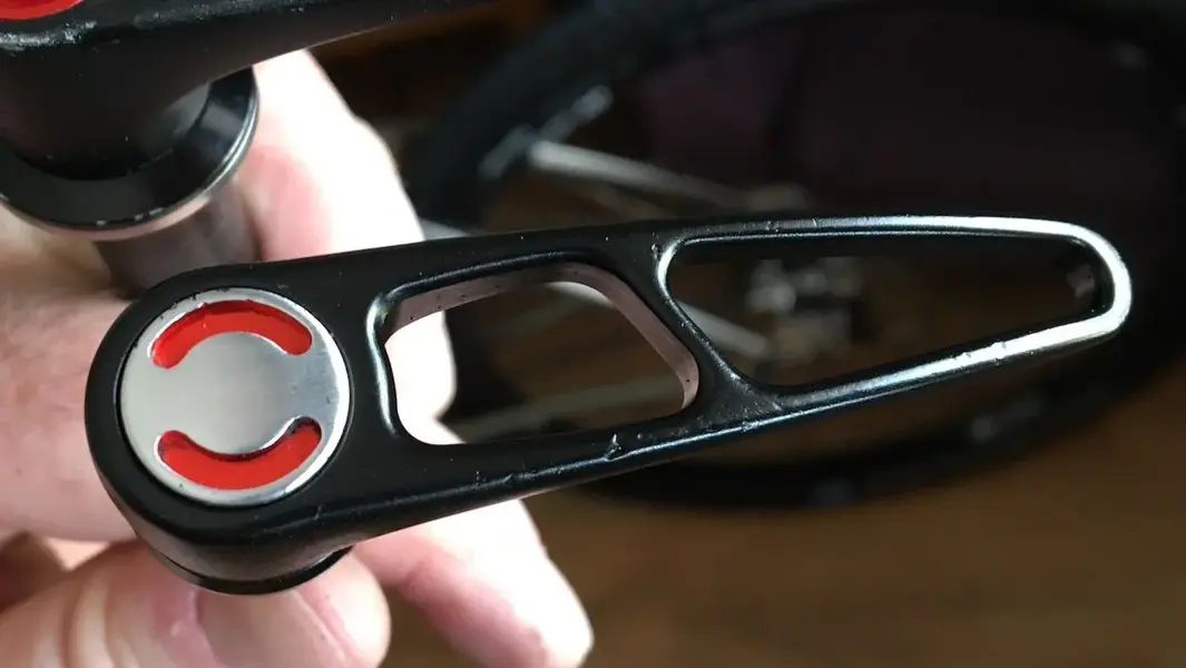

Quick freshen-up of the DT RWS skewers today, they were looking a little rough, and the two red centres didn't tie in with anything else on the black sheep, so I thought i'd have a go at doing something about that too whilst I was at it!
Dismantle, a quick sand, prime and satin black for the levers, and then the dremel was put to work to buff off the red centres, a light rub over with the same pad I used to finish the frame and then reassembly.... think they look much tidier now! 8)

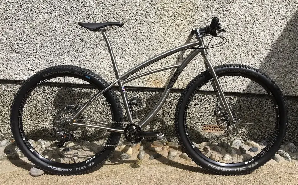

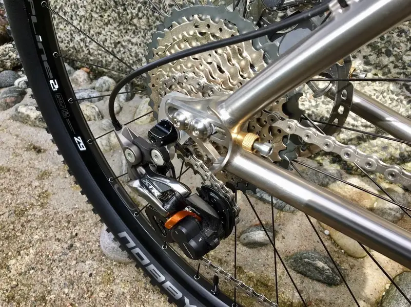

Fitted the CK bottom bracket this morning, along with a couple of other wee updates :oops: :facepalm: :roll:

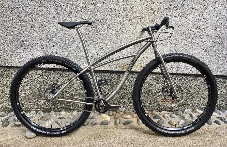

FINAL BUILD SPEC:
Black Sheep Titanium High Roller 29er frame with matching 15mm bolt-through forks
Chris King matte slate 1-1/8 GripLock headset
Chris King matte slate Threadfit24 bottom bracket
Enve MTN 70mm carbon stem
Answer 20/20 720 Pro Taper carbon bars
Airborne titanium 27.2 seat post with set-back
Fabric Radius Race titanium saddle
Salsa Lip Lock seat clamp 31.8
Shimano XTR 9020 175 cranks
Shimano XTR 9020 brakes
Shimano PD-M959 spd pedals
Shimano RT81 centre-lock discs 180mm
Absolute Black 32 tooth oval chain ring
Shimano XTR M9000 11 speed chain
Shimano XT 11-42 cassette
DT Swiss E1700 Spine 2 28 spoke 29er tubeless wheels
DT Swiss RWS skewers
Schwalbe Nobby Nic tubeless tyres 29 x 2.35 front and 29 x 2.25 rear
Ritchey WCS grips and end plugs
Black tubeless valves
Black bottle bolts
Assorted replacement titanium bolts
and a special mention to Gil for supplying the superb decals 8)

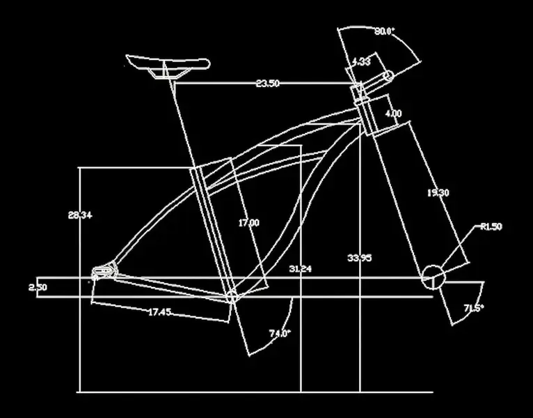

Geometry/sizing below:

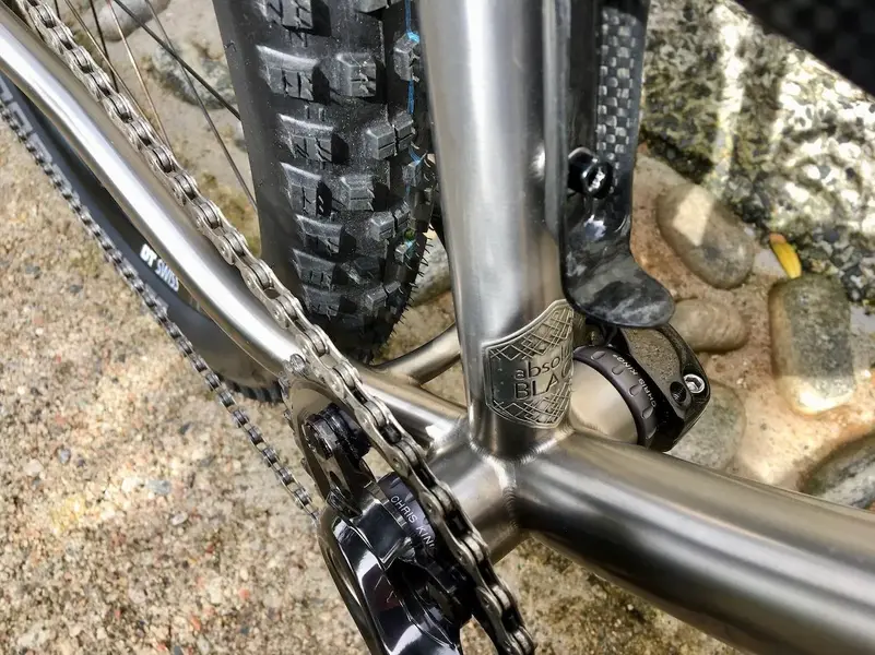

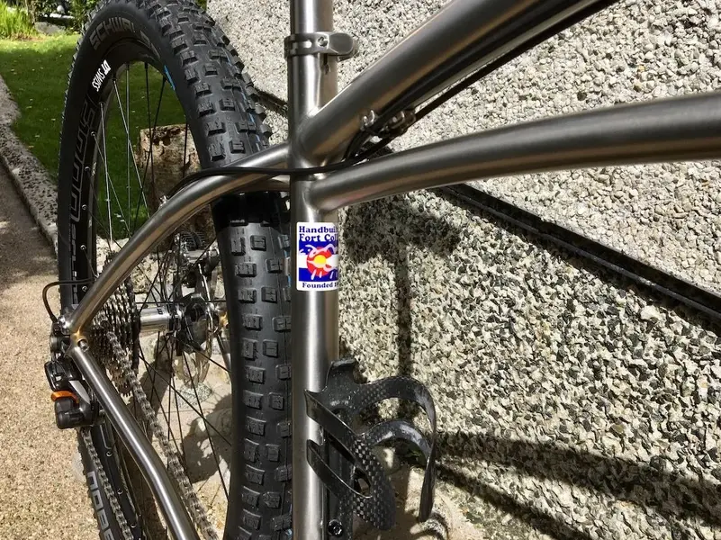

New seat tube decal from Gil arrived today and it looks great!
