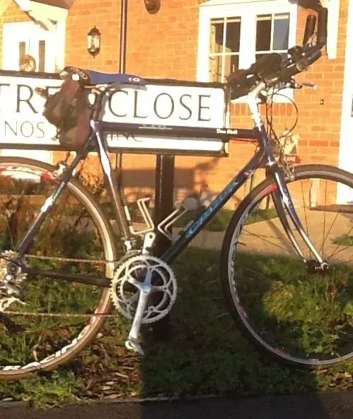

After loads of tweeking I've found this set up to be the most comfortable on any rides over 2 hours in length. Modern bikes tend to be too stretched out for my hobbit physique :-) Highly recommend the more upright position despite the piss taking involved...
Does look a strange set up....
Old school tt bikes generally have short top tubes. For comfort (lack of flexibility) a general rule of thumb is to get the bars the same height as the saddle. On modern bikes the Specialized Roubaix or Sectuar achieve this very well.
