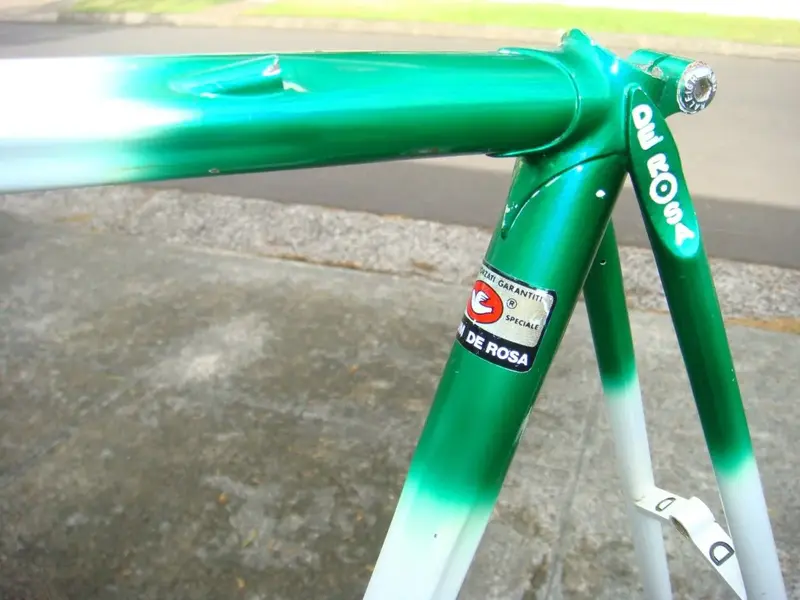

The cable fittings look similar to those seen on Columbus frames, may be that’s were I have seen them before. Not saying this is Columbus, but this is the closest I have seen so far, location is usually towards the top of the tube though.
