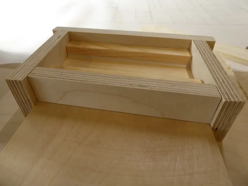

..built a little frame around the loose end section

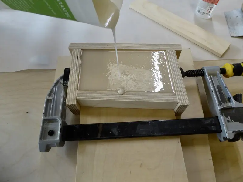

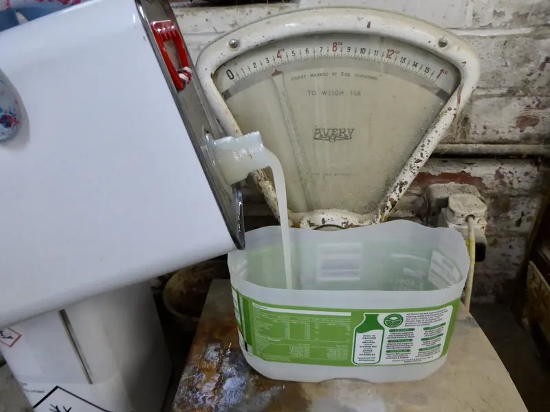

..mixed some polyurethane
..poured it into the frame, trying not to get it over the edges while simultaneously looking through the camera :rolleyes:

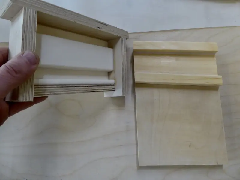

..removed the resin mould
..removed the loose section

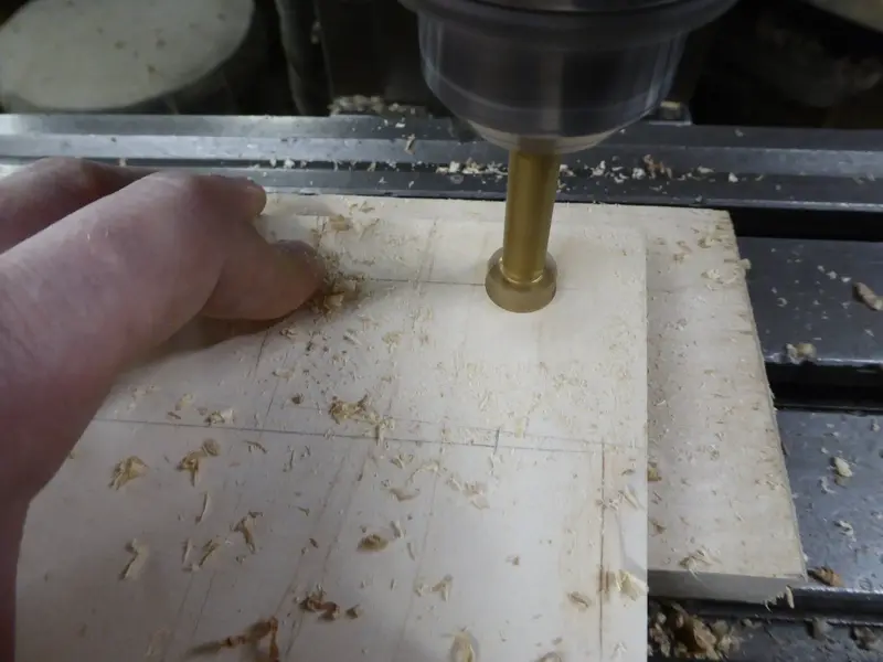

..drilled some holes under the loose section

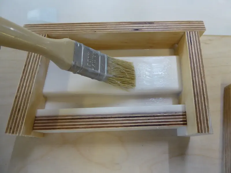

...coated the mould with mould release solution

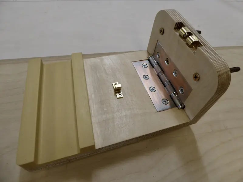

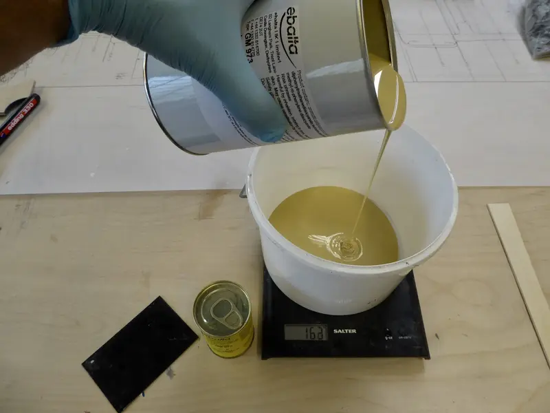

..mixed some rubberised resin

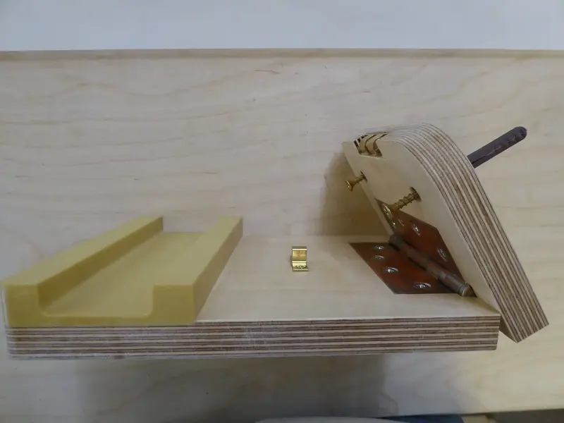

..put the mould back into position over the bracket with what was the loose section, now a cavity within the mould, poured in the liquid rubber, waited for it to cure and removed the mould, now the top tube can sit on a soft surface.
Dropped the rubber below the surface so it doesn't peal.

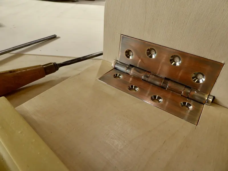

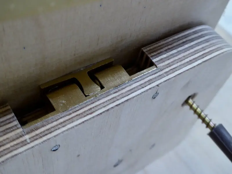

..super-bling chrome hinge offended my sensibilities
..so i rubbed it down with some wirewool and inserted and it into the brackets.
..added a little roller catch to hold it to the wall when not in use

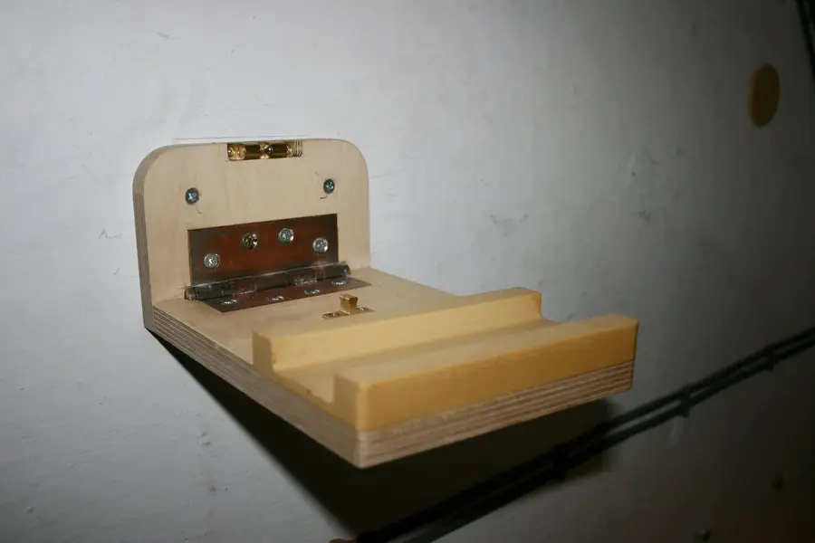

..and there you have it, the world's most overengineered bike hanger.
..painted the back with white paint to cover up the holes which i cast through
..poured what was left of the rubber into yogurt pots to make some soft pads and stuck them to the wall with contact adhesive.
..fin

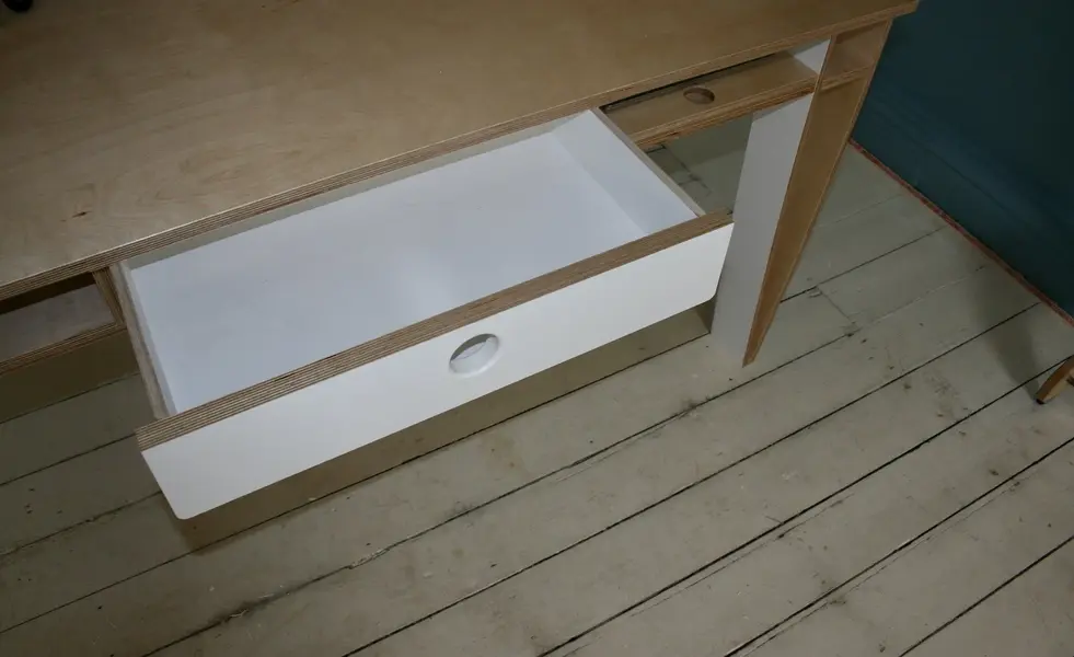

I took a few sheets home from work a few months ago and made my kid a desk, well it's my take on a console table/dest with curved legs.

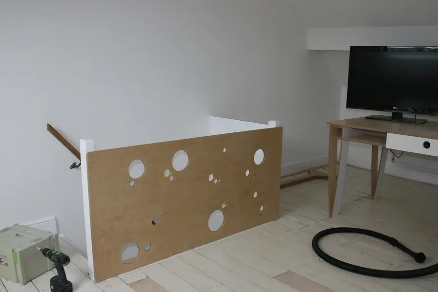

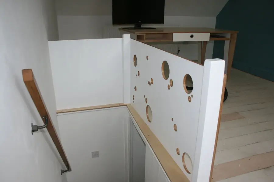

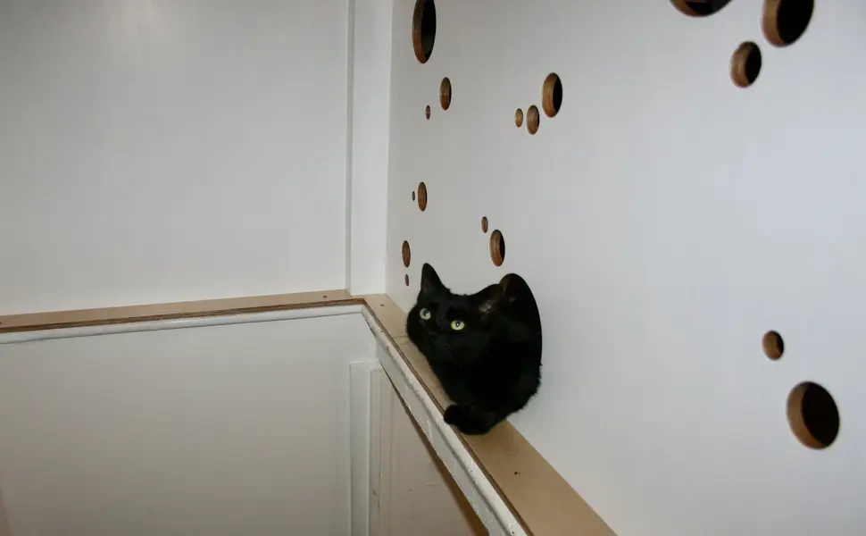

..replaced the shitty old balustrade while i was at it.
..the holes let light through and the cat likes to perch on the plinth
