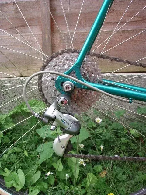

Ok, so I have modified the Merckx for lengthy climbs, as pictured (although saddle will drop half an inch).
Interestingly the rear mech is supposed to take a 26t rear sprocket as the largest. I slung some wheels in with a 32t and as you can see the rear mech seems to take it in it's stride without looking overly stretched or stressed. Haven't tried it under load yet but looking good (and I have a medium cage mech in reserve just in case).
Only thing left is to fit a shorter axled b/b as the front mech can't really cope with the new chainset fitted - removing a 20 year old fixed cup is a job I'll have to leave to the LBS!
