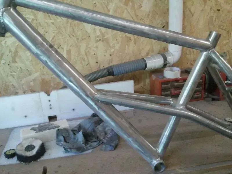

Decision time....the frame is need of a bit of tlc, its not in a bad way, just small niks and scratches...its been used..but i have decided to go back to bare and re polish to give it a new appearance.

What a job!!!!! getting the anodising off was a complete nightmare...ever tried peeling a potato with your finger nails.....

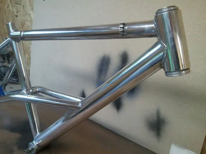

The frame just looked tired quiet a few marks so tried to carefully polish them out and one thing led to another......i was committed to a complete frame polish.
Just about ready for the re-build

to be honest the shine was easier than getting that anodising lacquer off, as soon as thats gone your back to ally and the shine came easily with the aid of a drill and mop/polish....glad to see the back of this rebuild so no more polishing for me for a while!!
Used 2 4" mops first one is a sisal mop with grey polish then soft stitched mop with green polish,,,polishingshop found in Google.
not sure what stage you are at but that anodising has to come off first...it takes some shifting.
I had mine acid dipped so there's nowt but alloy there that needs polishing!
