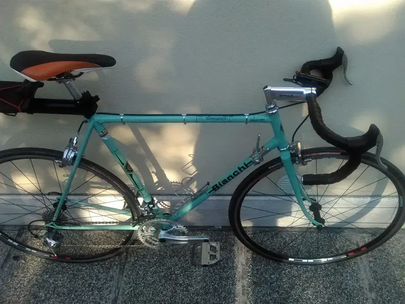

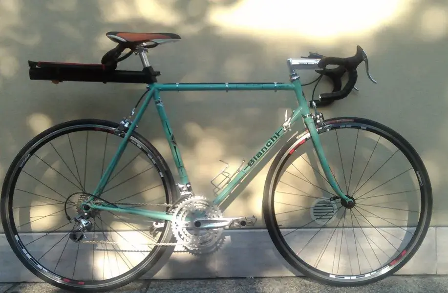

as promised, my old bianchi with the upgrades
Frame: Bianchi Rekord 745 – 1974?75? tg: v 57 c/f
Fork: Bianchi Rekord 1” Steel
Headset: OfMega 1” Thread
Stem: ZOOM trak 1” 130mm -16° 26mm
Handlebar: Deda 240 Ergo 420mm c-c
Bar Tape: BB carbonlook matte
Brake Levers/Brifters: Saccon (very cheap)
Brake Calipers: Miche Performance
Brake Pads: Ashima wet condition
Brake Cables: Shimano std
Shifters: ??? Downtube (5€) 3x10 friction
Front Derailleur: Microshift triple
Rear Derailleur: Shimano Tiagra 10v midCage
Derailleur Cables: Shimano SP41 black 4mm
Cassette: Shimano Tiagra 10v 11-28
Chain: Shimano Tiagra 10v
Cranks: Stronglight Aluminum triple
Chainrings: 30-40-50
Bottom Bracket: Miche Ita thread 122mm
Pedals: CrankBrothers 5050x
Rims: Shimano RS501
Hubs: Shimano RS501
Hub Skewers: Shimano RS501
Nipples: Shimano RS501
Spokes: Shimano RS501
Tyres: Vittoria Zaffiro 23mm
Tubes: Vittoria Zaffiro 23mm
Saddle: Fizik nisene CP
Seatpost: BrandX 26.4mmx400 aluminum
Seatpost Binder: integrated
Bottle Cage: ALE torino vintage
Extras: Rear pannier Zefal
Weight:? I think more than 12kg…
