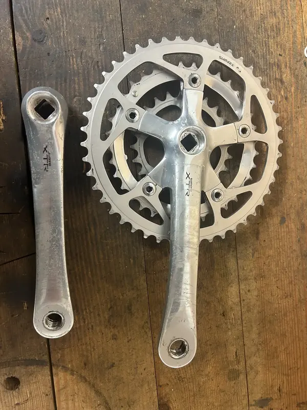

I’ve a pair of cranks which whilst the logos remain , the finish isn’t great. Mainly lacquer damage and pitting.
I see so many people polish them and stick a decal on which to my eye looks worse than they currently look.
So , has anyone successfully restored a pair ?
I’m thinking anodising them silver , some sort of decal and then lacquer.

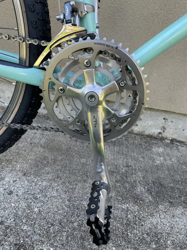

Here's one of mine that as been polished and then dulled down to more of a satin finish, I'm satisfied with the outcome:
They do look good. Far nicer than the polished up shiny ones that are always done.
Yeah, I did the satin finish on mine, much nicer than polished IMHO
