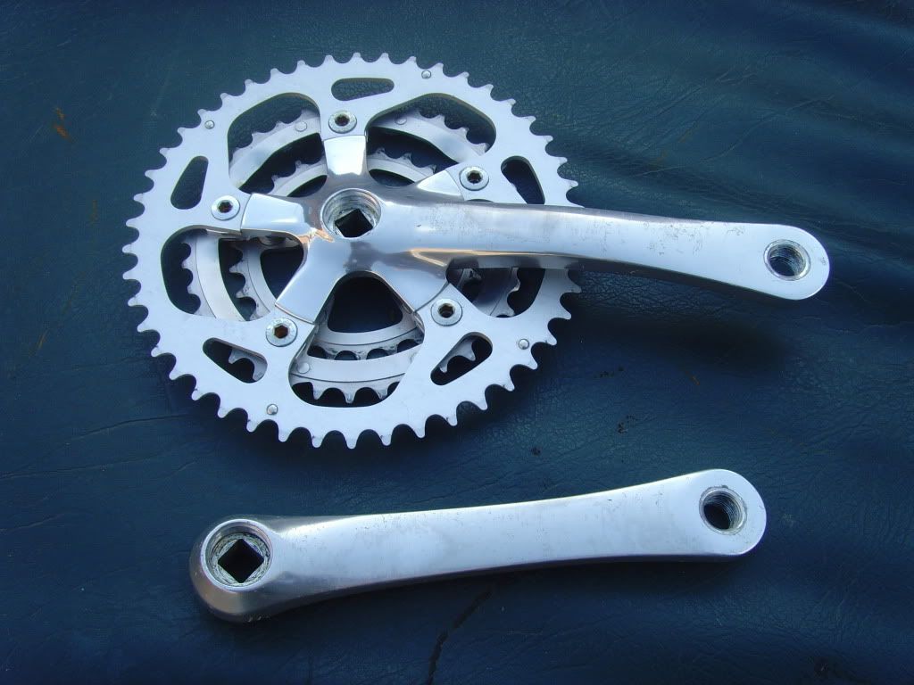

I have a set of xtr m900 chainset and it is dull and heel rub, so want to get them back up looking nice.
So how is best to do this?? i have a tube of autosol to use, so any tips ??

Will go take pic's now :wink:
Not best pic's as the light here is crap today.

if they are scratched or scored you'll need wet and dry before polish. use as fine a grade as you can but deep scored will need a coarse grain. go through the grades of paper then onto the polish
rojo":33uqnnun said:
So p60 dave??
No! 400 or 600 P60 will cause you a serious amount of work espcially on something the size of that. P60 will remove too much material.
I'll post some pics tomoorow of something i've done using 400 only.
