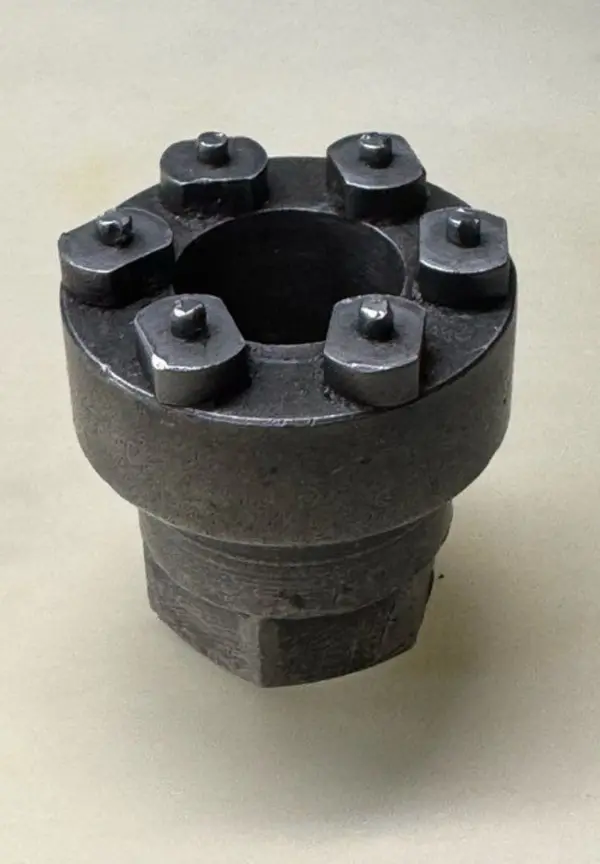

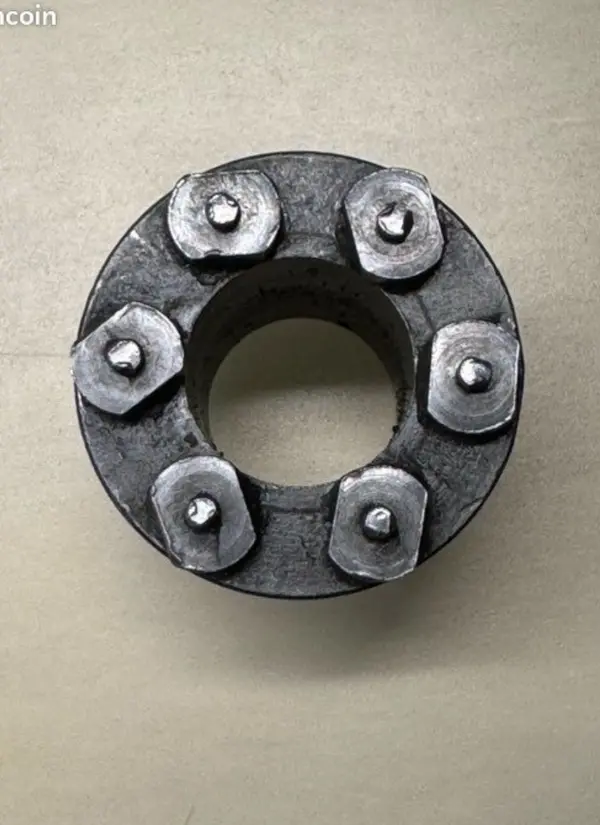

VAR 670 for removing vintage Mavic 630 and 500 bottom brackets

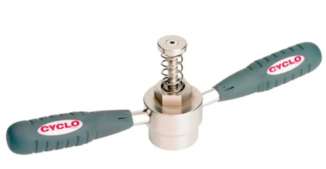

Shame they didn't think to include an axle bolt to hold the tool in place, like this cyclus (for shimano sq taper) 20250202_133041.webp
Pin tools for bbs are almost always pushed to the limit.
I think VAR tools are designed for the 'think out of the box' mechanics, those kind of people who improvise and then execute 😂
Although this bb tool takes the removal torque at quite a distance from the tool face, increasing the risk of slippage, and then tool and cup damage.

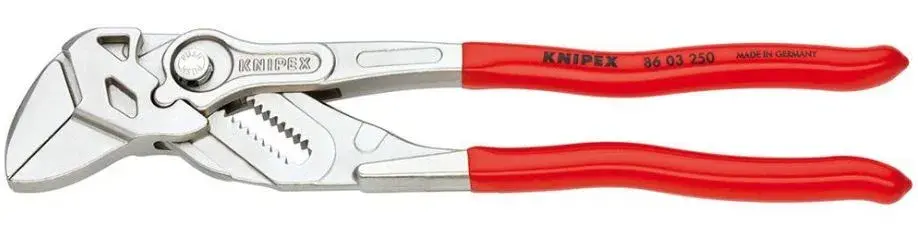

Have we discussed the Knipex Pliers-Wrench yet? In case you don't know, despite sounding terrible, they're actually the best tool I've ever used for soft alloy headset nuts. Expensive, but everyone who'd tried one raves about theirs.
Like an adjustable, but it applies force holding the jaws closed as you squeeze, so the size is always exactly right. Any fixed-size wrench has to be a little loose, or else it can't go on the nut (interference fit).
If you have one you'll find yourself using it all the time. No I don't have stock in the company!
