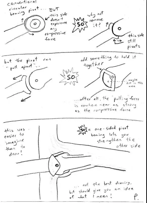

I'm not familiar with non circular bearings, but this is how the bearings are placed;
And I could do this sort of thing to help spread the forces to both sides;
Also I could use some of Titanium/Steel insert through the pivot. If the whole pivot went through the frame as a single piece of Aluminium, welded on each side, strength could be increased directly on the pivot.
