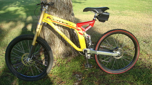

First principles would tell us that the closer the pivot is to the BB ; the less effect chain tension will have on the suspension. It's been done a few times in the motorcycling world :
http://www.flickr.com/photos/breganze981/2386406669/
for example ; but I don't recall seeing any bicycles designed with concentric pivots ( among the problems are excessive frame width as that Laverda shows). An engineer friend and I discussed this ; and the only possible solution we found was to use the BB shell itself as the inner part of the pivot ; then to wrap the outer part around it. Good Luck with the project!

^ Yup ; that's pretty much what we decided -- too much gubbins and too little space for it. Ultimately ; any design will be a compromise: You can make a frame to this design stiff enough by adding material ; so up goes the weight etc.etc. ; I'm pretty sure this is why most frames now are single pivot "Marin/Whyte" - ish frames ; it's the best overall compromise. As an aside ; ever seen one of these?
