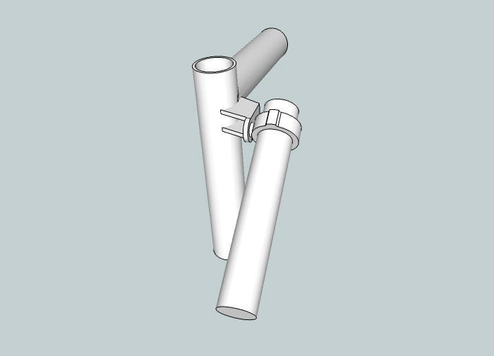

I'm not an engineer, but I think the chainstays will need to be beefed up. Also, I think there will be too much leverage on the upper seatstay pivot. Maybe make the pivot in-line with the stanchion clamp, and move the pivot out closer to the stanchion to reduce the torsional load on the pivot... something like this (just a quickie to communicate the concept):
