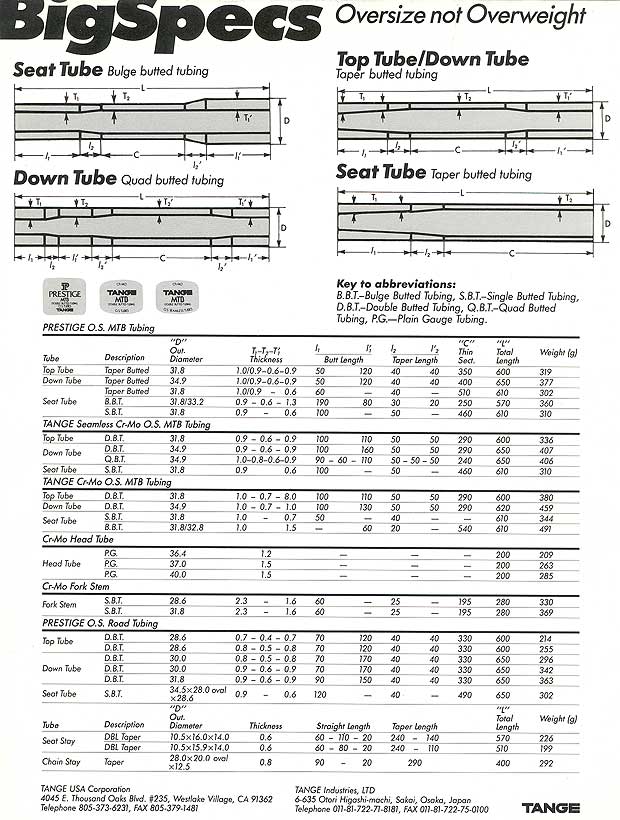

I thought that Tange Prestige was really meant for relatively light riders? Eg
desperadocycles.com/The.../About_Steel_Tubing_page4.htm
That's an interesting article, but I think it's very old and pre-dates the introduction of Tange Concept and Ultimate. For example the distinctive fluted Ultimate Ultrastrong down tube on the 93/94 Explosifs is by no means a lightweight tube.
But in general what he says about Tange Prestige is pretty silly, with all due respect to somebody who knows far more than I do. I'm afraid that frame-builders tend to try to aggrandise their own role so as to impress potential customers. The notion that Tange would design a tubeset and call it Tange Prestige MTB but it wasn't strong enough for MTB, even in the heaviest gauge they made available, isn't really plausible. The only data I have for Prestige MTB says that the gauge was either 9-6-9 or 10-7-10, which is by no means thin (my 97 Kilauea has a 7-4-7 top tube and 8-5-8 down tube and I haven't heard of heavier riders breaking them)
Plus if the article is that old - which I didn't notice - and it was right, then we'd be surrounded by Explosif shrapnel by now.
